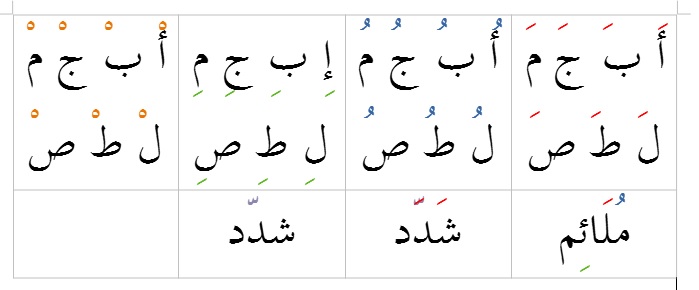

    It seems that this can't be done with Word. It could work with LibreOffice Writer, but with problems.‎
    Copy your text to Writer. Open Find and Replace (CTRL+H). Click Other Options and check Regular expressions and Diacritic-sensitive. In Find, type a diacritic (for example, the fat.ha). Type the same diacritic in Replace. Then click Format and choose the Font color that you want (under Font Effects tab). Click Ok, then click Replace All in Find and Replace. Repeat with other diacritics.‎
    I found that the most acceptable font for the whole text is Traditional Arabic. Here are some caveats:‎
    ‪- Diacritics could appear too high or too low
    ‪- The لا would appear as لـا
    ‪- Problems with shaddah+other diacritic
    PS: Not sure if this works with other languages that have diacritics.‎
