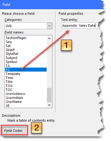

    With the cursor at the beginning of Appendix A, choose to insert a TC field, using the Insert > Quick Parts > Field dialog:

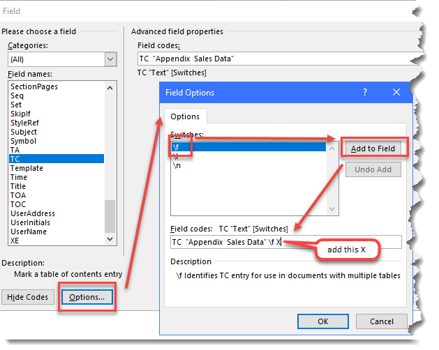

    In the Text Entry box, enter the text you want in the list of appendices, but leave two spaces for the appendix letter. Then click the Field Codes button at the bottom. This shows the advanced field properties. Click the Options button at the bottom to open the Field Options dialog.
    With the \f switch selected, click the Add to Field button. Then type a space and the letter X at the end of the field code. (Any letter will do.) Click the OK buttons in both dialogs. The field code will appear in the document at the cursor location.

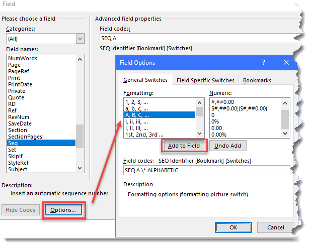

    Next, click between the two spaces following the word Appendix in the field code. Again use Insert > Quick Parts > Field, and this time insert a Seq field. At the end of the field code, type the letter A and a space. (Again, any letter will do.) Click the Options button. On the General Switches page of the Options dialog, click the A, B, C formatting and click Add to Field.
    Click OK in each dialog. The field in the document should now look like this:
