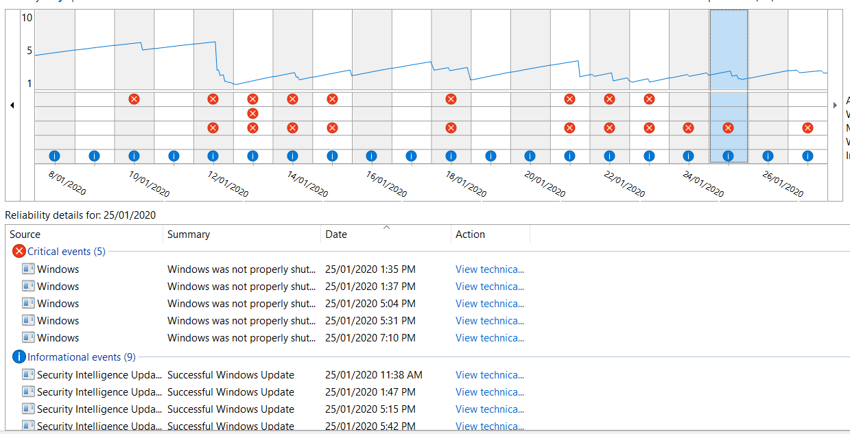

For a few months now I have been having constant BSOD crashing of my PC with error codes ranging from "critical process died" to "Unexpected store exception", the most common stop codes being the ones mentioned. I am using an HP laptop with an i7 7700HQ, 1050, 16GB Ram, 256 SSD, and a 1TB HD. The product number is 1HP08PA#ABG and the details of the model can be found here. Unfortunately, this crashing problem started occurring around a few months after the 1-year warranty had expired.
Every X on the reliability history above represents at least one crash...
