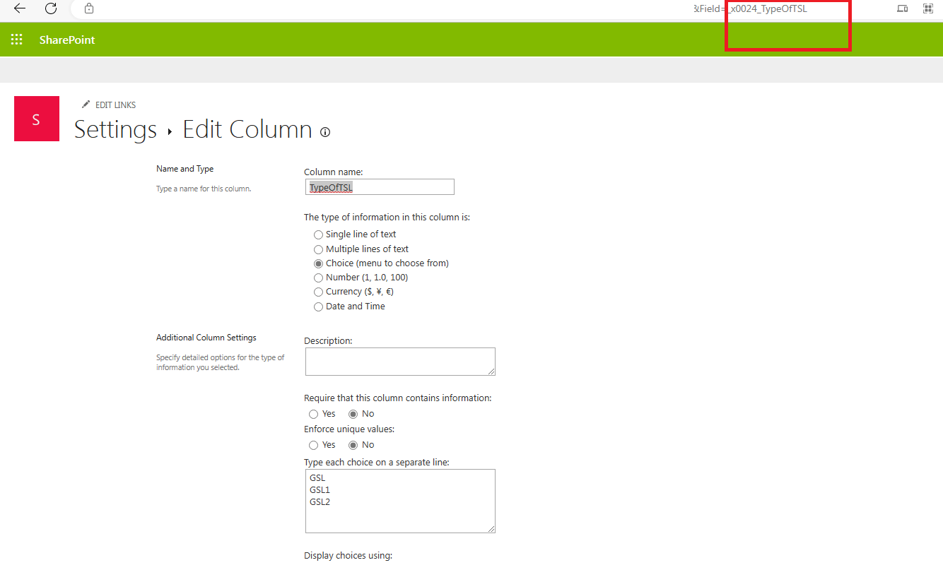

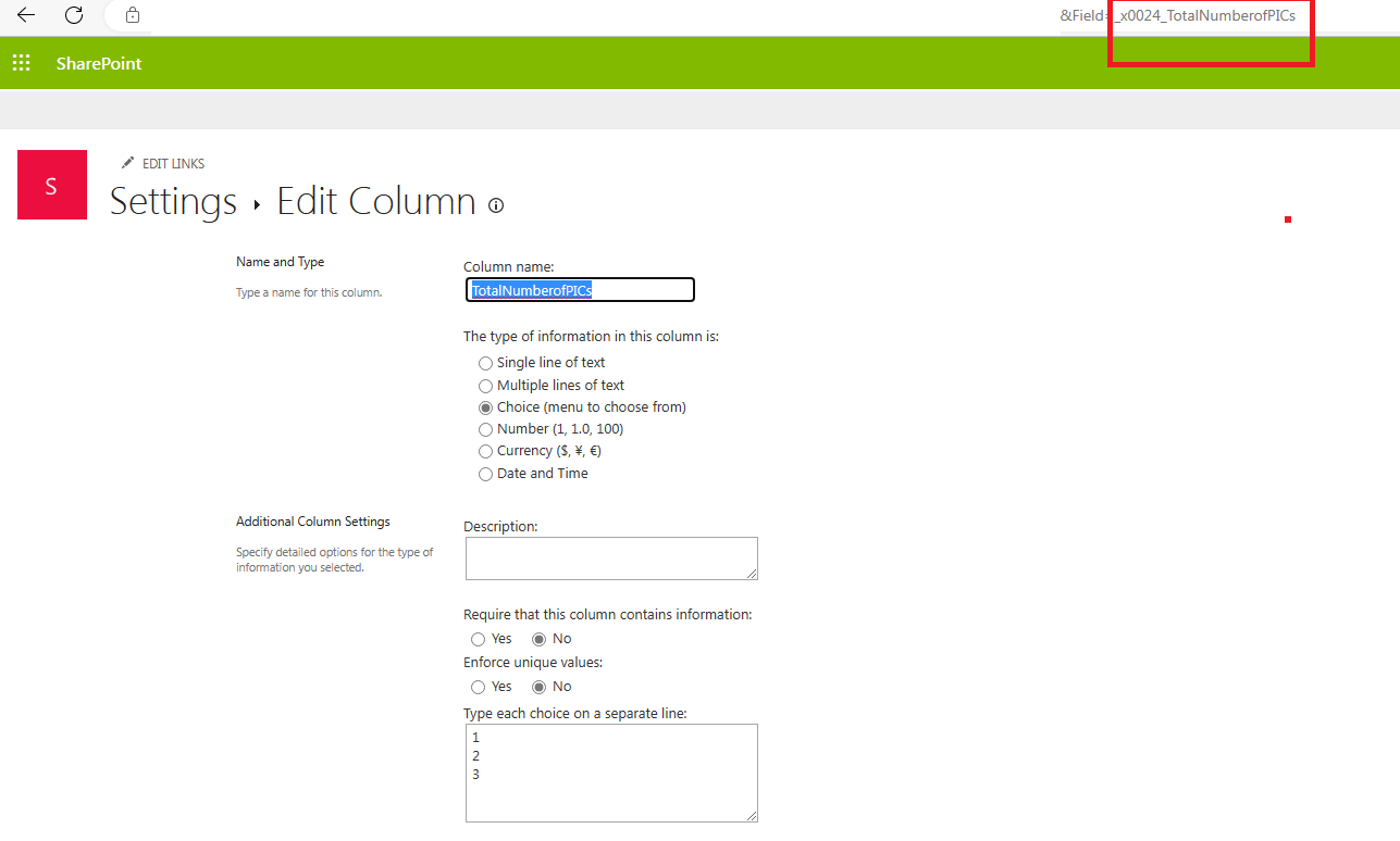

    As you are using the Conditional Formula feature, you may use the internal field names first. For example, you create the Choice column without multiple-choice enabled (The feature doesn't support the Choice column with multiple-choice enabled) TotalNumberofPICs and TypeOfTSL. You can get the internal field name by clicking on List Settings>clicking on the filed and get the internal field name from "Field=" as follows.
    In my environment, they are _x0024_TotalNumberofPICs and _x0024_TypeOfTSL.
    Now type the formula as following on the Conditional Formula edit window of 2 COK Holder.
    =if([$_x0024_TotalNumberofPICs]=='2'&&[$_x0024_TypeOfTSL]=='GSL','true','false')

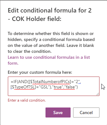

    2023-06-06T22:10:33+00:00
    Hi Cliff,
    Thank you for your reply.
    I have tried the formula you have suggested, copied and pasted and it sharepoint list says "Enter a valid Condition"?
    2023-06-06T06:13:36+00:00
    Dear Aleisha,
    You may use the formula as follows.
    =IF(AND([$TotalNumberofPICs]="2",[$TypeOfTSL]="GSL"),"true","false")
