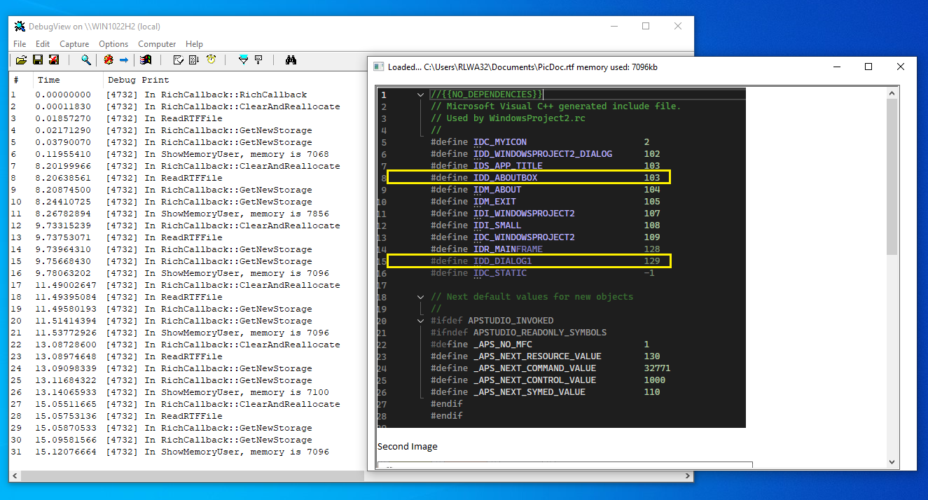

    @roy nelson You can control the memory usage when an rtf file contains images by implementing the IRichEditOleCallback interface. I haven't tested every type of image, but in a minimal test that loaded and reloaded an rtf file containing two images the memory leak appeared to be eliminated.
    I added some modifications to your posted code, including using the right mouse button to initiate the reload of the rtf file.
    Give this a try -

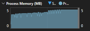

    I have investigated this and can confirm the memory leak is reproducible. It appears this is due to internal caching mechanisms within the control that do not free memory even after the control is destroyed.
    I attempted to resolve this doing these between loads:
    Unfortunately, none of these steps released the memory. As you can see from the picture, the memory usage continues to grow with each load (20 clicks).
    Since the leak is contained within the current process, I found that creating the RichEdit control in a separate process and then terminating it, which seems to be a viable workaround to avoid running out of memory in this specific case.
    But frankly, this is not an ideal solution. Having to spawn a separate process just to host a control is quite heavy-handed and may introduce additional complexity in terms of inter-process communication.
    I doubt there is much that can be done to fix this, as it seems to be an inherent issue with the control itself. This control hasn't received any major updates for years. It is better to look for other alternatives.

    Yes, unfortunately I pasted it in... the GetNewStorage only seems to be called when I paste from the clipboard.
    My document contains PNGs, I think it will use GDI+ to display those.
