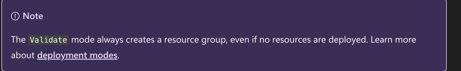

Before actually deploying the resources with deploymentMode: 'Incremental', I wanted to validate the template with deploymentMode: 'Validation'. Unexpectedly, the defined resources were created. To my understanding, Validation will create the resource group if it does not exist, but not the resources.

    Welcome to Microsoft Q&A, Even though you're using Validation deployment mode, resources might still get created because the AzureResourceManagerTemplateDeployment@3 triggers a deployment rg operation not just a dry-run validation. In Azure Pipelines, this task doesn't strictly isolate validation from execution unless explicitly scoped. The Validation mode checks the template's syntax and resource availability, but if the resource group doesn't exist, it will be created.
    However, actual resources (like your Container App and Environment) should not be created unless the deployment action is misconfigured or the pipeline overrides the mode internally.
