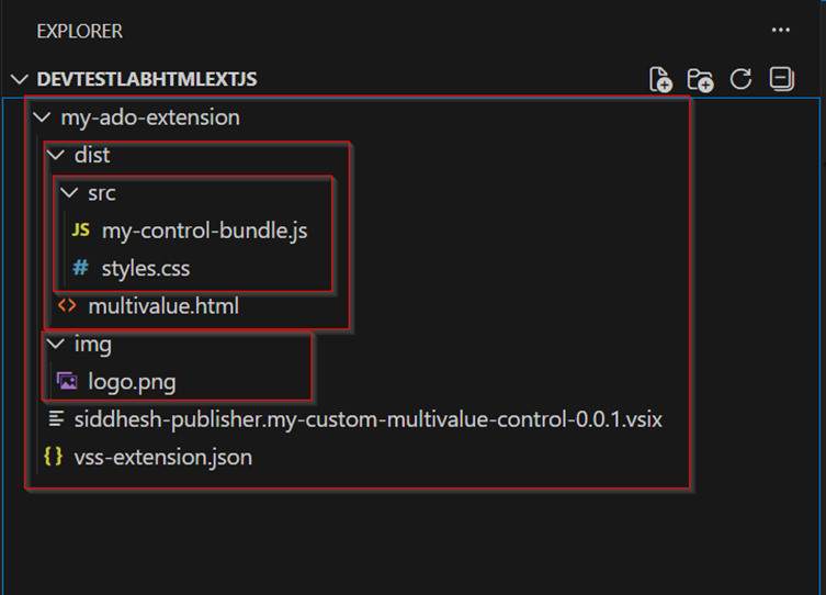

    I tried creating custom multi-value DevTest like extension, and here are the steps I followed:
    Here’s my Folder structure:
    my-ado-extension/
    dist > Inside dist
             ``> multivalue.html
             ``> src > my-control-bundle.js > styles.css
    vss-extensions.json

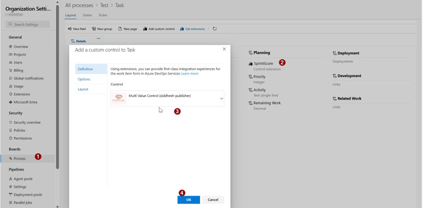

    Click on Publish extensions on Top Right > Create Publisher > Make sure the name of the Publisher and ID matched what you have added in the vss-extension.json.
    Upload your vsix file and share the extension with your organization:
    Visit your organization settings > Boards > Process > Select one Process > Select one Work Item, I have selected Task > Now > Select one Field > Add custom control > Select your custom extension and saveUser's image Now, create a new Task in your work item the new custom field will be visible.
