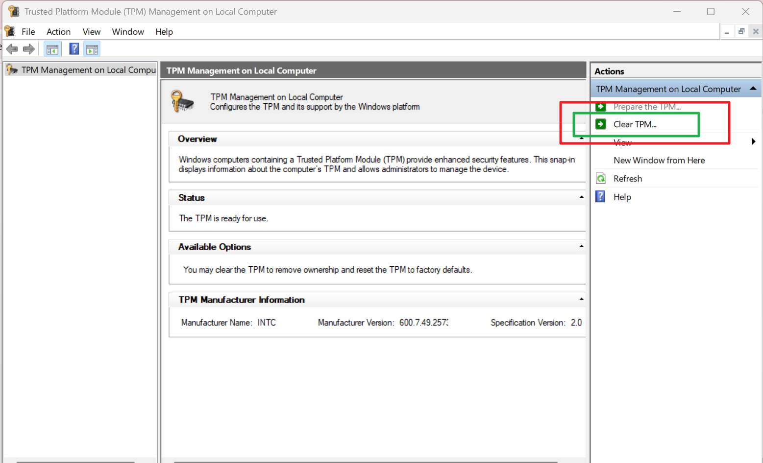

    Try resetting TPM
    go to start --> run --> tpm.msc 00> clear from right top corner, restart device after this.
    If still not working then try removing device from intune/Entra restart device -- Enable bitlocker -- Join device back to Entra/Intune.
