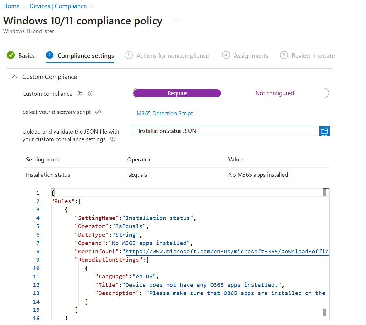

    2. On Intune portal, go to Devices -> Compliance -> Scripts. Click Add-> Windows 10 and later. Give a name for the script like "M365 Detection Script" and create.
    3. JSON file:
         "Rules":[
                "SettingName":"Installation status",
                "Operator":"IsEquals",
                "DataType":"String",
                "Operand":"No M365 apps installed",
                "MoreInfoUrl":"https://www.microsoft.com/en-us/microsoft-365/download-office?msockid=39fe2c4b6cda608038173a6d68da6684",
                "RemediationStrings":[
                      "Language":"en_US",
                      "Title":"Device does not have any O365 apps installed.",
                      "Description": "Please make sure that O365 apps are installed on the device. "
      Save this file locally.
    Compliance Policy Configuration:
    1. On Intune portal, go to Devices -> Compliance -> Policies -> Create Policy Platform: Windows 10 and later Profile Type: Windows 10/11 compliance policy
    2. Click Create and give a name for the policy
    3. Under Compliance settings -> Custom Compliance -> Require
    4. Select your discovery script and upload the JSON saved locally. User's image
    5. Click next and Configure actions of non-compliance
    6. Click next, add assignments and create the policy.
    Once the devices are synced with the policy, you should be able to see the status of non-compliant ones (No M365 apps installed). Additionally, on the end device you will see the description from the JSON as the reason for compliance.
