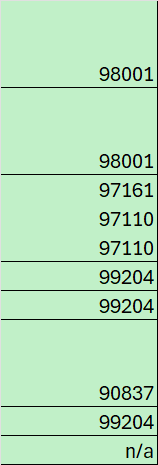

I have an excel spreadsheet that has various values in a column. Some are single response, some are multiple response, and some are n/a. I need to write a macro where if there is 1 value in column A then put a "1" in column B. If there are 2 values in Column A then put two "1"'s in column B, if 3 values in column A, then put 3 "1''s in column B ect... If there is an n/a, just skip that row. Here is what my raw data looks like in the first image.
.User's image

    You can loop through each row, check the cell in column A, and write the appropriate number of 1’s in column B. For multiple-response cells, this assumes the values are separated by either commas, semicolons, or spaces—adjust the Split delimiter as needed.
    Here is a sample VBA macro:

    If your multiple responses are separated by commas, replace:
    parts = Split(cellValue, " ")
    with:
    parts = Split(cellValue, ",")
    This writes 1, 2, 3, ... depending on how many values appear in column A, while skipping n/a.

    Count of Substrings
    Excel Formula (Single Cell)
    =IF(LEN(A2)=0,"",IF(A2="n/a","",REPT("1",LEN(A2)-LEN(SUBSTITUTE(A2,CHAR(10),))+1)))
    Excel Formula (MS365)
    =LET(a,A2:A6,r,"1",n,"n/a",d,CHAR(10),
        IF(LEN(a)=0,"",IF(a=n,"",REPT(r,LEN(a)-LEN(SUBSTITUTE(a,d,))+1))))
    VBA
    Sub GenerateResponseIds()
        ' Define constants.
        ' Both
        Const SHEET_NAME As String = "Sheet1"
        ' Source
        Const S_TOP_CELL As String = "A2"
        Const S_STRING_DELIMITER As String = vbLf
        Const S_NA_STRING As String = "n/a"
        ' Destination
        Const D_COLUMN As String = "B"
        Const D_REPEAT_COUNT_STRING As String = "1"
        ' Clears the excessive rows when the data previously had more rows than now.
        ' If the number of rows will only grow, set it to 'False'.
        Const D_OK_TO_CLEAR_COLUMN_TO_BOTTOM As Boolean = True
