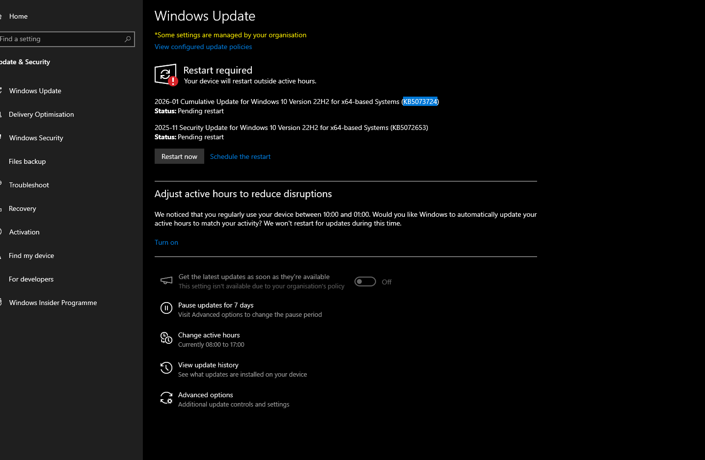

Hello,
Ever since the latest security update (see title) , my system freezes at random.
And I have to press and hold the power button to shut down the system.
I cannot uninstall the update from CMD/Powershell/Safe Mode or the regular way, as it says it is an essential thing.
This is the windows version:
Windows 10 22H2, OS Build 19045.6809
I don't expect a solution from anyone, but I do hope that someone from the dev team is seeing this and will look for a fix, or even offer a way to undo this update as it breaks more than it solves.
There is also a thread on reddit where people experience similar problems with Steam and Discord... I only have it when I work in Maya , Substance or DaVinci for a while (haven't tested Discord or Steam) but in less than an hour it will happen and it is getting pretty annoying.
Thanks!

    I am really getting angry at Microsoft now ... I did an inplace upgrade of windows , blocked updates beyond December via policy and you (BLEEPS) still forced this shitty update : KB5073724 unto me so now I have to do YET ANOTHER (BLEEP)ING reinstall :
