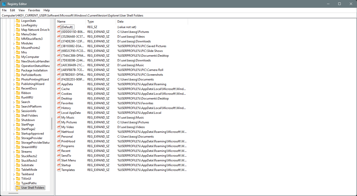

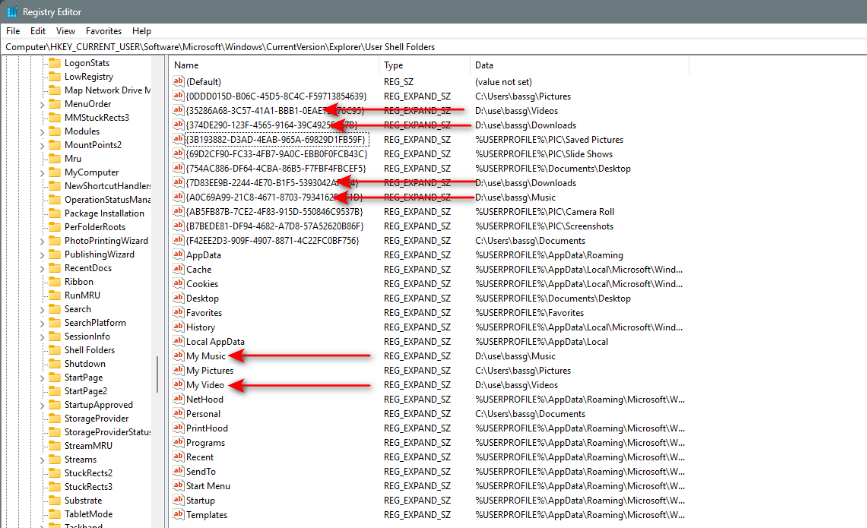

DaveM121 918.5K Reputation points Independent Advisor
2026-02-14T15:54:51.25+00:00
1
On your previous PC, were some of the user folders moved to the D drive?
2
Click your Start Button, type regedit and hit Enter to open the Registry Editor.
Click View and make sure 'Address Bar' is turned on.
Paste this into the Address Bar at the top and hit Enter.
HKEY_CURRENT_USER\SOFTWARE\Microsoft\Windows\CurrentVersion\Explorer\User Shell Folders
Please provide a screenshot of that Registry Editor page.
