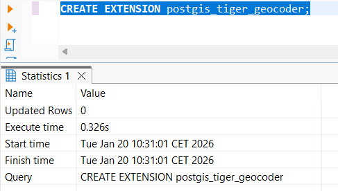

However, trying to run the command
CREATE EXTENSION postgis_tiger_geocoder;
from Dbeaver to destination database does not cause any errors.

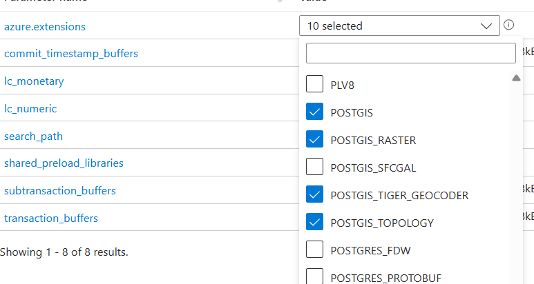

I added the following extensions to the server
Screenshot 2026-01-20 110816
and also I changed search_path and shared_preload_libraries

    Although postgis_tiger_geocoder is enabled at the server level and you can successfully run CREATE EXTENSION postgis_tiger_geocoder; manually from DBeaver, DMS runs its own pre-validation using a restricted migration identity and a fixed execution order. During this step, DMS always attempts to create required extensions itself. For postgis_tiger_geocoder, this can fail because the extension has hard dependencies on other PostGIS components and internal objects, and DMS does not always detect that the extension already exists. The migration identity used by DMS also does not have the same effective privileges or search path context as an interactive user session.
    This explains why manual creation of the extension succeeds while the DMS validation reports “Unable to create postgis_tiger_geocoder extension(s)”. Your azure.extensions configuration is correct, and changing shared_preload_libraries is not required for PostGIS or the tiger geocoder. This is also not related to PostgreSQL 16 compatibility.
