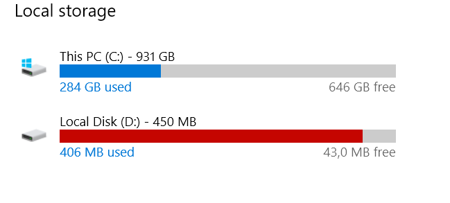

I installed the new April update and since then, I’m getting a disk error:
You are running out of disk space on Local Disk (D:).
I see I have 406mb/449mb of used space, but how to fixe that?
I look into the disk, there is nothing! I tried a clean up, but there is nothing to remove.
Thx

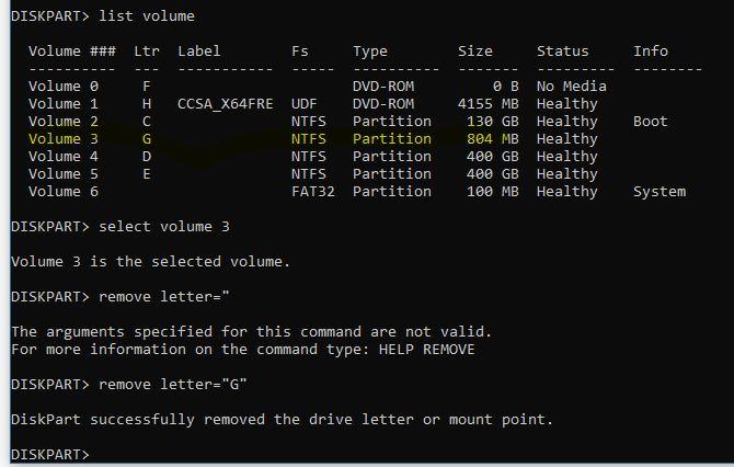

Understood. I am too affected by this and used diskpart to remove the drive letter. For me G was assigned.
Right-click Start>Command Prompt(admin)
Type in the following:
diskpart
list volume
select volume 3
Replace 3 with the number of the volume which is assigned a drive letter.
remove letter="G"
Replace G with D
Don't worry, removing a drive letter would not cause any harm to your device.

    2018-05-01T03:30:32+00:00
    Thank you.
    I used Diskpart as you mentioned and as mentioned on reddit.
    I did:
    >diskpart
    >list volume
    >select volume 1 (which was my (D:) disk)
     >REMOVE LETTER=D
    Had to use HELP REMOVE before, because wasn't sure how to type it, but it has shown some explication and examples.

  4. Sumit 44,226 Reputation points Volunteer Moderator
    2018-05-01T03:00:44+00:00
    This is one of the known issues I am seeing with the update as Recovery partition should be hidden and is accidently assigned a drive letter.
    Please remove the drive letter and the nag should go away.
