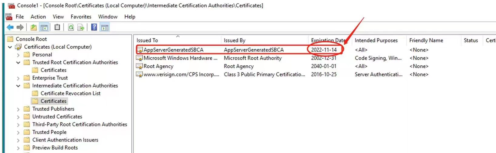

Hello, we have a system used Service Bus long time ago, almost 5 years. now, we met Certification Experation issue as the picture.
My question is if I can regenerate the cerfitication or any solutions I can fix this issue.
Sorry for the short description because I have no experience for Service Bus. if need more details please let me know.

    @Daisy-3967 Thanks for reaching out. It looks like you are talking about service bus and not Azure bus service. Please confirm if my understanding is correct.
    I have research and to renew the certificate, you need to change the change the time on your server to before the certificate expired date and then update the certificate, below article will help you to update/renew certificate.
    http://www.harbar.net/articles/wfm3.aspx
    https://social.technet.microsoft.com/Forums/en-US/a123f2c0-33af-4a56-9ffa-5a6296703ef9/problem-with-servicebus-certificate-error?forum=sharepointadmin
