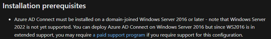

  1. Carlos Solís Salazar 18,291 Reputation points MVP Volunteer Moderator
    2022-11-30T16:16:53.033+00:00
    Hi @KKDevops
    Thank you for asking this question on the **Microsoft Q&A Platform. **
    I understand that you are trying to install Azure AD Connect in a Windows Server 2022, right?
    If this is the case, unfortunately, Windows Server 2022 is not yet supported
    Source: https://learn.microsoft.com/en-us/azure/active-directory/hybrid/how-to-connect-install-prerequisites#installation-prerequisites
    Hope this helps!
