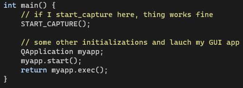

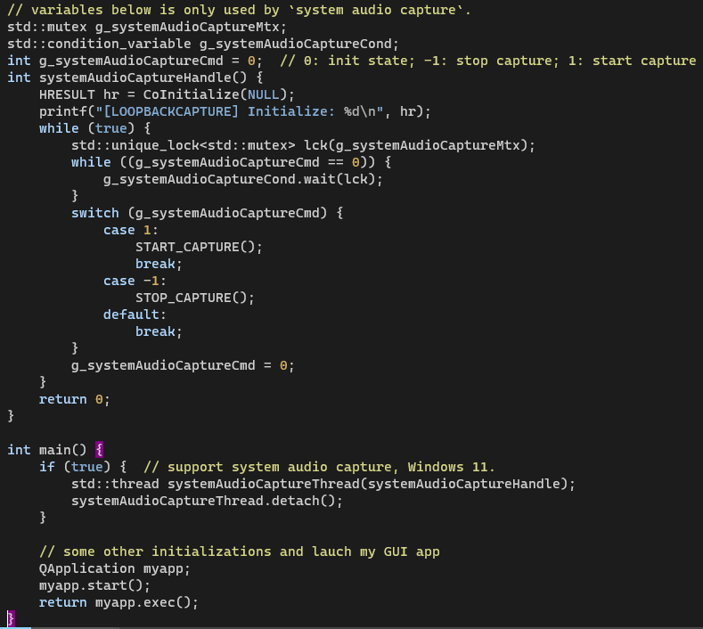

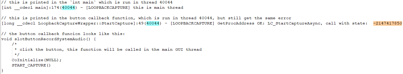

Hi, I try to record the system audio by using applicationloopbackaudio-sample, it's ok; Then, I just compile it as a dll (exporting some interfaces) and link it to my GUI(QT) project (multithreading), however, when I call StartCaptureAsyn , I just get the error code: -2147417850 (0x80010106) ((failed in ActivateAudioInterfaceAsync);
Actually, it sometimes works fine, most times not; And if I try to adjust the function call position (say my app initializtion place), it works; if I put it into a callback function (say click a button, call the StartCaptureAsync), it may not work. I don't know why.

    RPC_E_CHANGED_MODE indicates A previous call to CoInitializeEx specified the concurrency model for this thread as multithread apartment (MTA). This could also indicate that a change from neutral-threaded apartment to single-threaded apartment has occurred.
