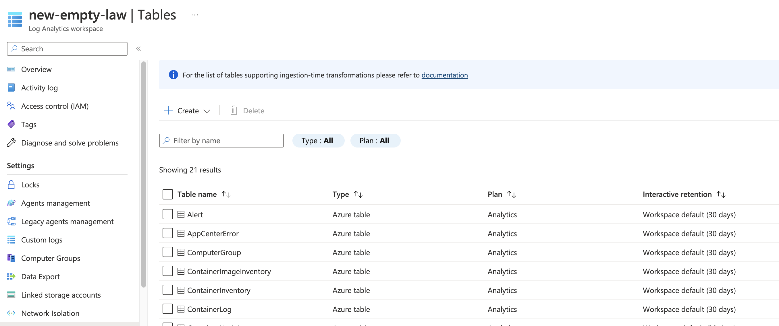

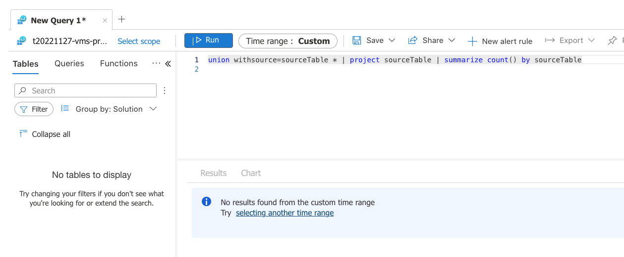

Same behaviour is visible when configuring a new empty LAW tables:
AzureDiagnostics table cannot be configured because it does not exist....

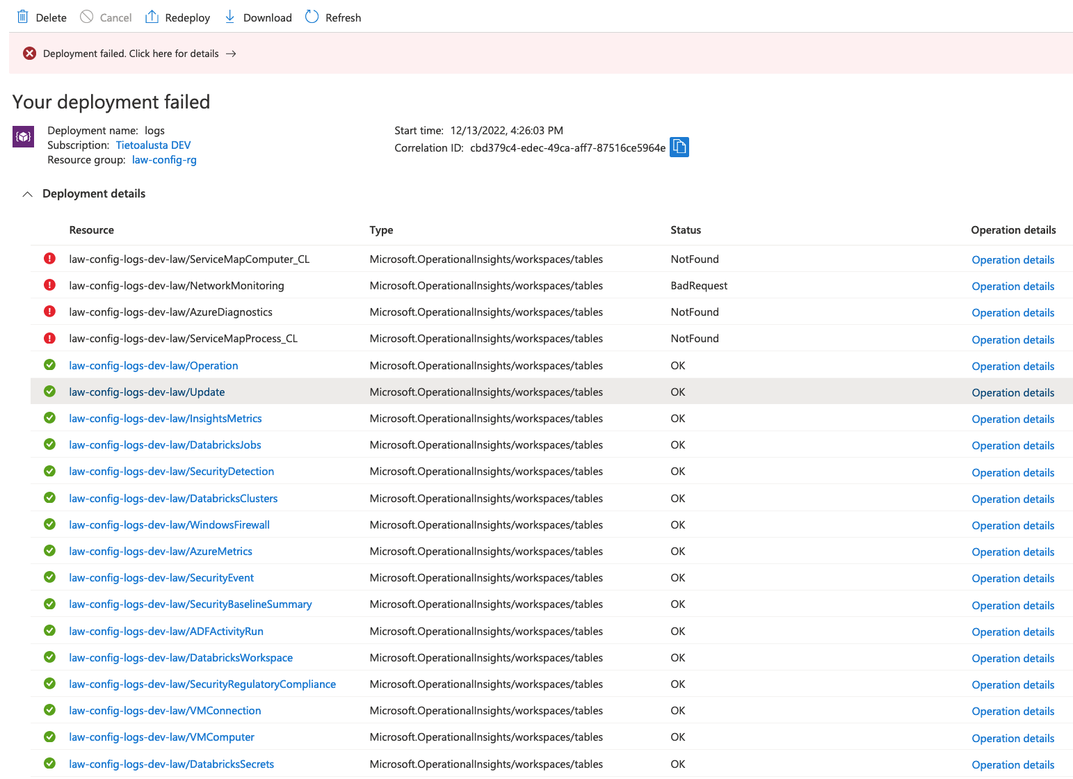

  2. deploy template: az deployment group create -g law-config-rg --subscription $DevSubscriptionId -f logs.bicep
  3. result:
law-config-logs-dev-law/ServiceMapComputer_CL, law-config-logs-dev-law/NetworkMonitoring and law-config-logs-dev-law/ServiceMapProcess_CL failures can be ignored in this discussion. The problem is AzureDiagnostics:
    "status": "Failed",
    "error": {
        "code": "ResourceNotFound",
        "message": "The specified table: 'AzureDiagnostics' does not exist. Operation Id: '229d68376b117a19f9214c2dfcab92c0'"
