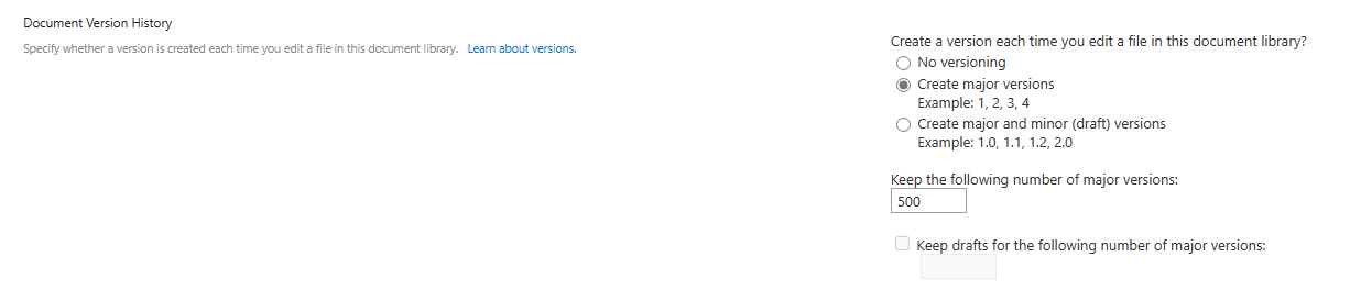

    Do you mean that you do not want a minor version after a file is edited? If you just want a major version, you could set the version settings as below without turning off "check-out is required" function.
