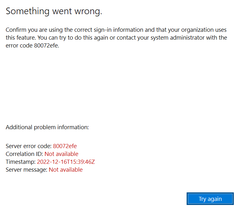

  • I have tried going to Settings > Accounts > Access Work or School > Connect > Join this device to Azure Active Directory, and walking through the credentials wizard with my USGov credentials, then I receive an undefined error. This VM does have outbound internet access and I am able to successfully login to USGov via browser. 271472-capture2.png

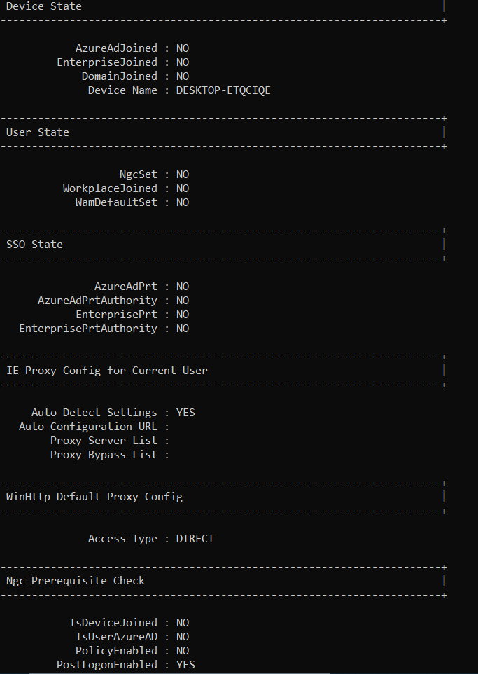

  • dsregcmd /status reports AzureAdJoined = no 271416-capture3.png
