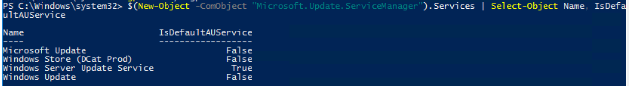

The 2016 servers do say they are set to default to WSUS.

    I agree, I don't see any WUfB entries in your gpresult, so that's good. I also don't see any reasons for dual scan. Also, your PowerShell output shows WSUS as the handler for your updates, so that's good.
