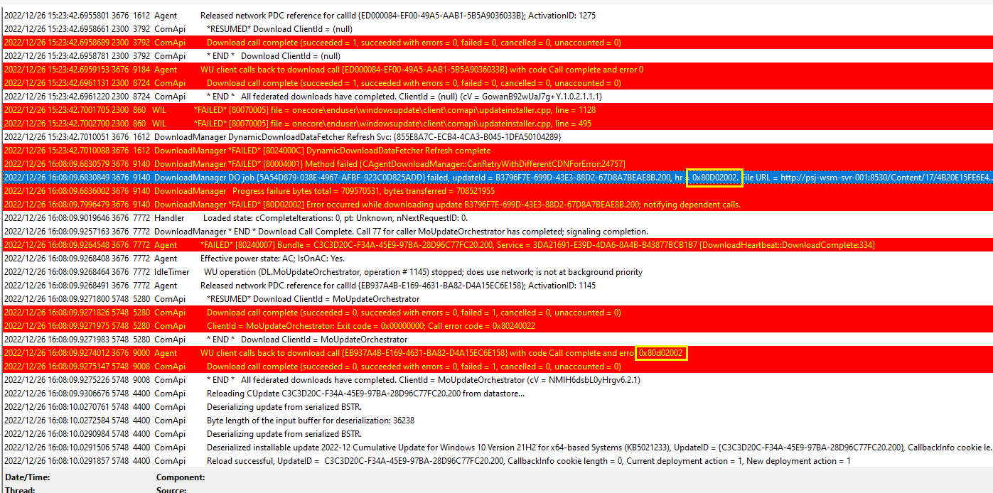

    1, Does such an error exist only on one machine? Do other clients have this problem too?
    2, According to the logs, the error "0x80d02002" only appeared on the 26th, as shown in the screenshot. Have you done anything? Is the problem solved automatically?

  3. Valentinus N Fao 1 Reputation point
    2022-12-28T07:43:36.103+00:00
    I'm sorry, after I stayed a few days, the error continued, suddenly my client was installed.
    Here's the log asking for help to check
    If stuck downloading again what should I do
    Thank you in advance
    274512-windowsupdate.log
