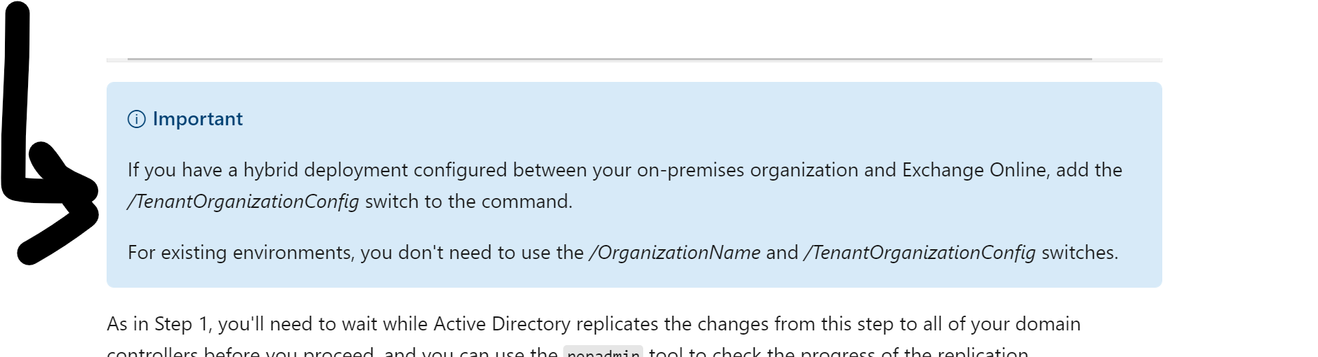

  3. Andy David - MVP 159.7K Reputation points MVP Volunteer Moderator
    2022-12-26T14:27:50.12+00:00
    There was no need to add that switch (TenantOrganizationConfig) if hybrid already existed:
    https://learn.microsoft.com/en-us/exchange/plan-and-deploy/prepare-ad-and-domains?view=exchserver-2019
    Undo whatever changes you made to that object via adsiedit and run the command again WITHOUT that switch!
