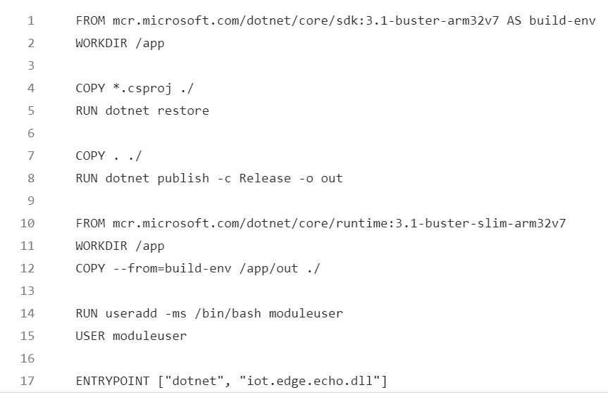

I have an Edge Module which is EdgeHub Triggered, and the .csproj file looks like -
The local.settings.json file consists of key value pairs, I want to use the config in the in-process azure function with Startup.cs file.
But it is returning the values as null every time. I tried to read it as environment variable but still it is giving null.
What could be a good way to add configuration file and read it from local environment as we will not be able to use device twin in our production environment.
