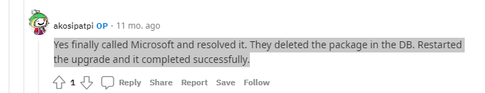

    Finally, I found a similar threader, to resolve this problem we need to delete MMASETUP-AMD64.EXE from the DB. I recommended that you finished it under the guidance of MS support engineer. We can open a support case with Microsoft from following link:
    Services Hub (microsoft.com)
    The similar threader link for your reference:
    https://www.reddit.com/r/SCCM/comments/s8epx4/failed_to_upgrade_sccm_to_2111/
    Note: Microsoft provides third-party contact information to help you understand the problem. This contact information may change without notice. Microsoft does not guarantee the accuracy of this third-party contact information.
