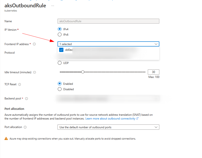

    I had the same problem. In my case, it turns out that I had a single Frontend IP configuration containing 3 rules mapped to it (2 x Load balancing rules for TCP ports 80 and 533 + 1 x Outbound rule).
    I saw that the assigned IP address was the one used for inbound and load balancing rules so I attempted to create a new Frontend IP configuration with the name set the same as the outbound rule public IP address ID. I then, got exactly the same error as described in this issue and that the name is already used - perhaps the reconciliation process was attempting to do exactly the same thing I was doing manually.
    Going right to the point, in my case, it worked by making sure that:
    • there was one Frontend IP configuration named based on the "Load balancing rules", have the rules assigned to it and the load balanced IP addressUser's image
    • there was one Frontend IP configuration named based on the outbound IP address ID and have the aksOutboundRule assigned to it
    Note sure if this thing with two separte IP address (1 for inbound and 1 for outbound) is a regular practice but this is how it was setup on a similar environment on my side. I hope this helps others, if not this particular configuration, at least this area of configuration.
    Afterwards, I run the reconciliation command @Eddie Neto sugested in this thread and all well.

    Please revert the public IP address in SLB back to the right IP to resolve the conflict, then retried the reconcile of the cluster by running "az resource update --ids /subscriptions/<your subscription>/resourcegroups/<resource group of the AKS>/providers/Microsoft.ContainerService/managedClusters/<name of the AKS>"
    • Check as well if you have some "RequestDisallowedByPolicy" that is blocking you.
    • Also check if there is any other IP selected here inside of Outbound Rules.

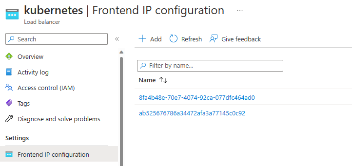

    I suspect that this 28548feb-70a2-4779-8711-89becdd51691 is pointing to the name of a public IP address of your Load Balancer under Frontend IP Configuration, e.g.:
    Doing my research, there seems to be a very similar error message described in the following external StackOverflow link:
    [https://stackoverflow.com/questions/69559293/azure-kubernetes-service-aks-no-longer-able-to-create-new-nodepools
    Can you please check if you see a duplicate name or IP in that section? Your Load balancer resource should be under your MC_Resource Group.
    From the StackOverflow link, a workaround is removing the IP configuration to resolve that duplicate conflict.
