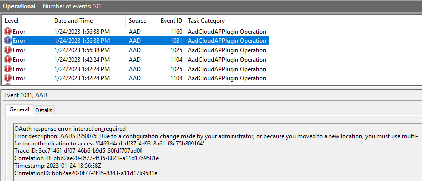

  1. vincent manzari 41 Reputation points
    2023-01-24T14:04:11.34+00:00
    Hello all,
    I have checked and run all tests, include recreate servers (VMClinet and VMServers)
    Now, when I try to login from the VMCLient (Vm is AD Registered on Azure AD) to VMServer (Vm is AD joined and with the extention corretly installed) I see these error on the Event Viewer from the VMServer
    Http request status: 400. Method: POST Endpoint Uri: https://login.microsoftonline.com/ea13cfea-b639-4fde-bc89-84b4c059bd98/oauth2/token Correlation ID: BBB2AE20-0F77-4F35-8843-A11D17B9581E
    OAuth response error: interaction_required
    Error description: AADSTS50076: Due to a configuration change made by your administrator, or because you moved to a new location, you must use multi-factor authentication to access '0469d4cd-df37-4d93-8a61-f8c75b809164'.
    Trace ID: 3ee7146f-df07-46b6-b9d5-30fdf707ad00
    Correlation ID: bbb2ae20-0f77-4f35-8843-a11d17b9581e
    Timestamp: 2023-01-24 13:56:38Z
    CorrelationID: bbb2ae20-0f77-4f35-8843-a11d17b9581e
    Logon failure. Status: 0xC0000250 Correlation ID: BBB2AE20-0F77-4F35-8843-A11D17B9581E
    Here the screenshots
    For my account, I have the MFA active, but I have configured exclusions on Conditional Access for the cloud apps (VM Login and also for the app with the name of VMServer.
    Can you help me to understand why it doens't work?
