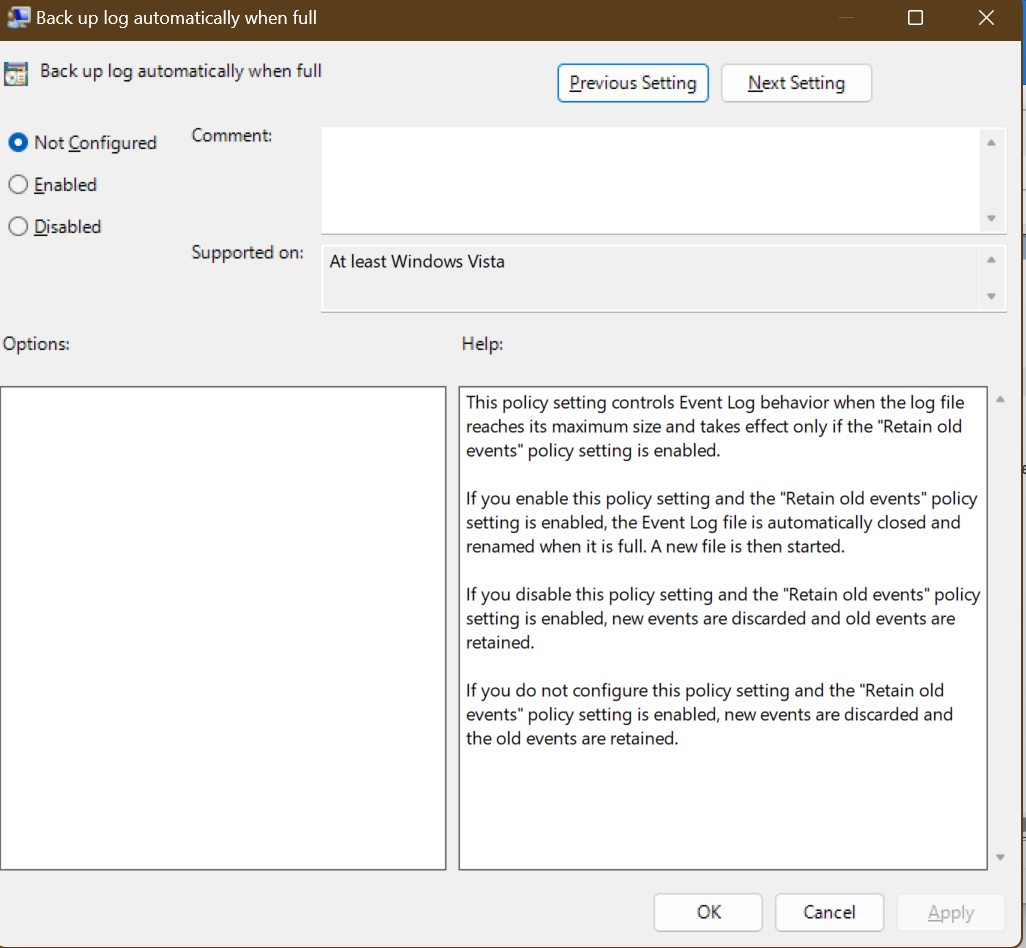

Method 2: increase the Size of the Security Log or Configure the log to overwrite as needed
Step 1: Click Start, tap on All Programs then on Administrative Tools and the click Event Viewer
Step 2: Right-click Security and then click Properties
Step 3: Under Security Log file Properties, the default setting are show below Maximum log Size-512KB
Overwrite events older than 7 days.
Step 4: In order to increase the amount of space for log size just change the maximum log size value to the higher log size value
Step 5: To configure the log to overwrite as needed, then just click the Overwrite events as needed option under when maximum log size is reached.
Step 6: Click OK > then close Event Viewer.
