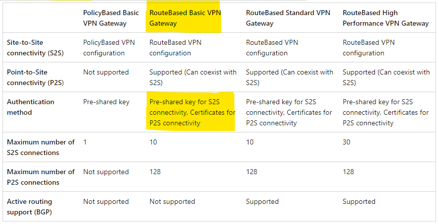

    First, I would like to draw your attention towards the P2S VPN support on Basic VPN gateway. Point to site VPN gateway can only be configured on a RouteBased Basic VPN Gateway and only SSTP connections are supported. If you are using a PolicyBased Basic VPN Gateway, then point to site VPN configuration will not be available.

    Azure Point-to-site VPN doesn't support L2TP protocol. The pre-shared key authentication option is only available for site-to-site connections.
    Refer: https://learn.microsoft.com/en-us/azure/vpn-gateway/vpn-gateway-vpn-faq#how-does-my-vpn-tunnel-get-authenticated

    From your screenshot, it looks like you have a RouteBased Basic VPN Gateway. For a RouteBased Basic VPN Gateway, the protocol is by default set to SSTP, and you cannot see a tunnel type option. You will only see a "Root Certificate" option to upload root certificates for P2S VPN connectivity.

    If you don't want to use SSTP protocol or Azure certificate authentication, then you need to upgrade your VPN gateway to a SKU which supports other protocols such as IKEv2/OpenVPN and authentication such as AzureAD/Radius.
    With the exception of the Basic SKU, you can resize your gateway to a gateway SKU within the same SKU family. For example, if you have a Standard SKU, you can resize to a HighPerformance SKU. However, you can't resize your VPN gateway between the old SKUs and the new SKU families. For example, you can't go from a Standard SKU to a VpnGw2 SKU, or a Basic SKU to VpnGw1.
    Refer: https://learn.microsoft.com/en-us/azure/vpn-gateway/vpn-gateway-about-skus-legacy#resize
    The resizing of VpnGw SKUs is allowed within the same generation, except resizing of the Basic SKU. The Basic SKU is a legacy SKU and has feature limitations. In order to move from Basic to another SKU, you must delete the Basic SKU VPN gateway and create a new gateway with the desired Generation and SKU size combination.
    Refer: https://learn.microsoft.com/en-us/azure/vpn-gateway/vpn-gateway-about-vpn-gateway-settings#benchmark
    Meaning you cannot re-size or upgrade your Basic SKU to any other SKU via Portal. To change to the new gateway SKU, you need to delete the existing VPN gateway and create a new VPN gateway.
    Refer: https://learn.microsoft.com/en-us/azure/vpn-gateway/vpn-gateway-about-skus-legacy#change
