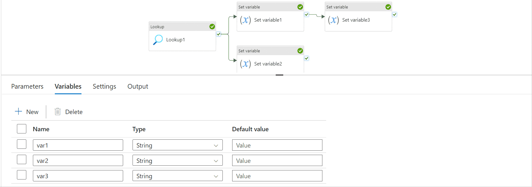

    I tried to reproduce your case, it looks like the symbols are not being treated as a valid string when we use replace function .
    The workaround I would suggest is to remove all the symbols by the following expression
    and then replace the remaining string variables(testValue) with the variable value.
    So here is the reference video of the pipeline.
    1. Use lookup activity to fetch the table content
    2. Associate two set variable activities with it. First one referencing var1 with this expresion:
       @replace(replace(replace(replace(activity('Lookup1').output.firstRow.col1,'{',''),'}',''),'\',''),'"','')
    And second set variable referencing var2 having the value you specified , say, 'GUID'
    1. Add another set variable activity to replace 'variables(testValue)' with 'GUID'
       @replace(variables('var1'),'variables(testValue)',variables('var2'))
    setvar
