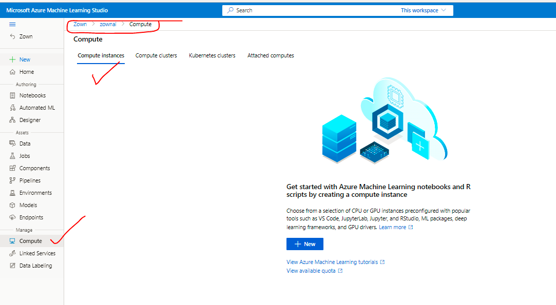

When deploying a model in Azure ML, I got the "not enough quota". So I shut down the machines in Azure ML but I get the same message again:

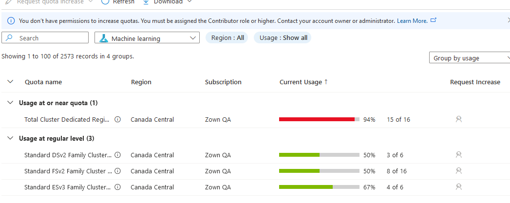

Then I checked the portal "Quota Usage" and it is like this:
First question: Are these two conflicting? If not how do I am supposed to free up my usage ( and not request more quota)

I remember that I created these resources and (as you see from the first image) I have deleted those machines.How come they are still there and considered as my used quota? I only use Canada central region.

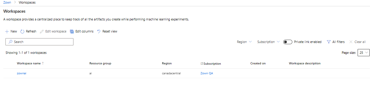

on the screenshot) that may have compute resources?the point is that I had not been using resource at the time I took the screen shot.

I do not have other workspaces:

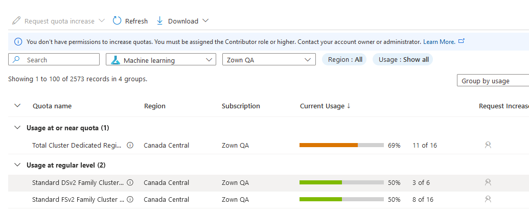

However,FYI, I have turned one machine on after posting those two images. which has been added up. And yet I could not find those other resources.

In fact, it was the endpoints which were consuming the resources.
I had 11 missing compute cores:
My colleague and I had created 3 one-core machines and one 4-core machine with 2 instances which add up to 11 cores. (Though the deployment failed but it consumed and dedicated the resource.
One I shut them down, the resource got free.
