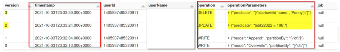

    By default, Delta tables in Azure Databricks store transaction logs that track changes made to the table. These logs can be used to recover the table in case of a failure or to revert to a previous version of the table. You can use the DESCRIBE HISTORY command in Databricks to view the transaction history of a Delta table.
    The logs and history available in Delta Lake tables can help you identify whether an overwrite operation was successful or not.

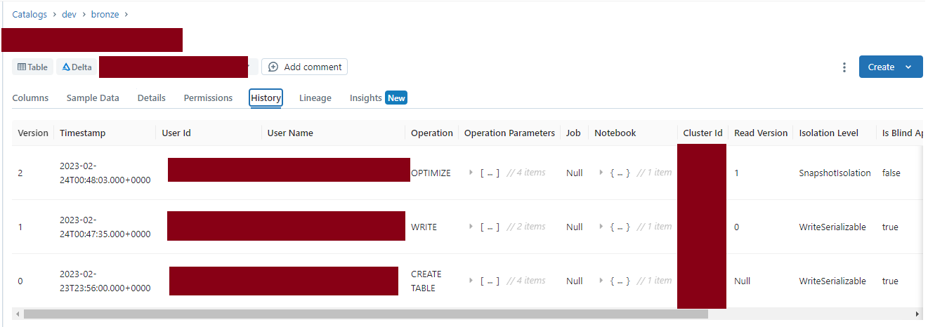

    Below are the steps to check those logs:
    1. Open your Azure Databricks workspace and navigate to the Delta Lake table that you want to check.
    2. Click on the 'Data' tab and select the 'Table History' option.
    You can see operation parameters details like Overwrite , Append , etc in operationParameters column.

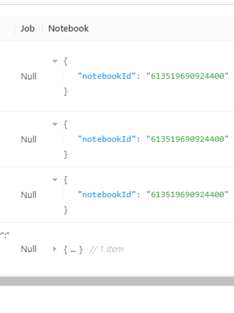

    You can also verify the job details and notebook details in job and Notebook columns.
    By following these steps, you can check the logs and history of a Delta Lake table in Azure Databricks to identify whether an overwrite operation was successful or not.
