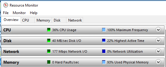

Is there some kind of speed cap when I copy data in Azure, if so how do I extend it? If there is no speed cap, why is it acting like this?
2023-03-29_161331
The source server have a 12 000 GiB Standard HDD LRS with 2000 Max IOPS and 500 Mbps thoughput. The source server isn't doing anything else at the moment than serving the file to the destination server.
Recource monitor of source server
2023-03-29_161000
The destination server have a 8192 GiB Premium SSD LRS with 16000 IOPS and 500 Mbps max throughput. The destination server is a development database server but is not under heavy load-
Recource monitor of destination server
2023-03-29_161429

  2. Peter Björklund 0 Reputation points
    2023-03-30T14:00:04.78+00:00
    How do I set the IO size and how would that change the fact that I have 100MB/s in transfer speed during the first 100GB of data then it drops to 20MB/s? I figure that if the IO size was the issue I would experience the speed drop long before 100GB is transfered.
