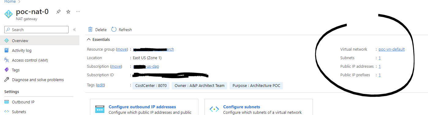

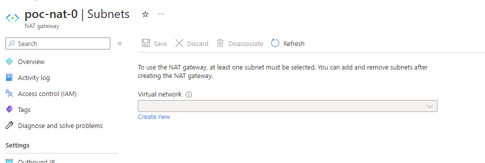

When I go to the subnet list it shows this and no virtual networks are viewable in the list image

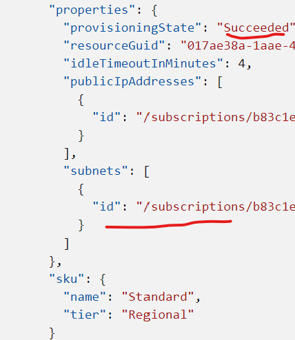

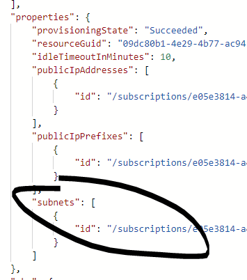

But when I go to the JSON view, it shows this: User's image
Everything about how the terraform project is set up seems correct. Is this a UI bug?

    Update: after 24 hours, the UI is now showing the correct values everywhere. I guess it just takes time

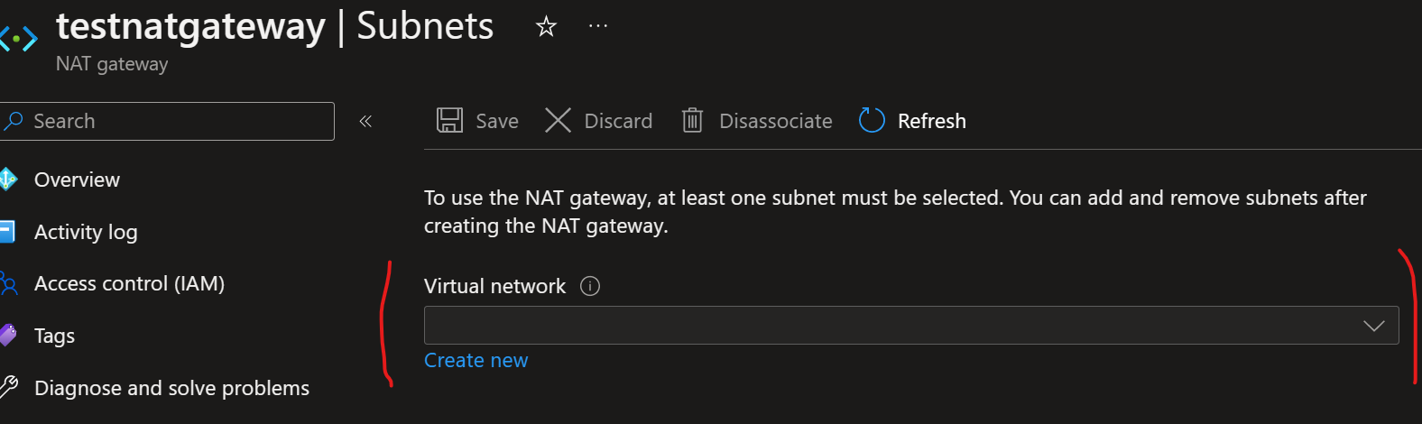

    @Peter Roca Thank you for sharing your resolution here. I was able to reproduce this issue at my end and it is a portal UI bug. I have reported this as a bug to Azure Portal team internally. User's image
    An alternate way to confirm if the NAT Gateway deployment was successful. You can perform this REST API call which will list the details for your NAT Gateway resource (the results should match your JSON view above.)
    I will make an update here as soon as the bug is fixed, meanwhile it will be helpful if you could mark this answer as accepted so that anyone in the community facing similar issue can find it helpful. Please let me know if you have any questions. Thank you!
