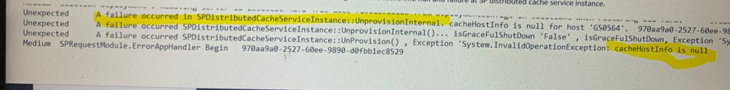

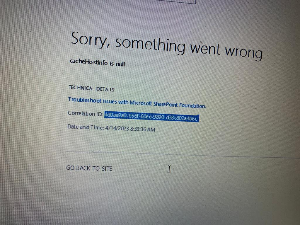

As part of troubleshooting for the distributed cache issue, we have planned to remove the 2 Distributed cache servers from farm and adding back to farm. I have noticed while running product config wizard, I have not found the role to choose Distributed cache role instead it was just showing normal way of running config wizard like legacy versions, but it is SharePoint 2016 We have 9 servers in farm 2 WFE, 2 Distriuted servers and 5 App servers: Here are the high level steps I am planning to implement,

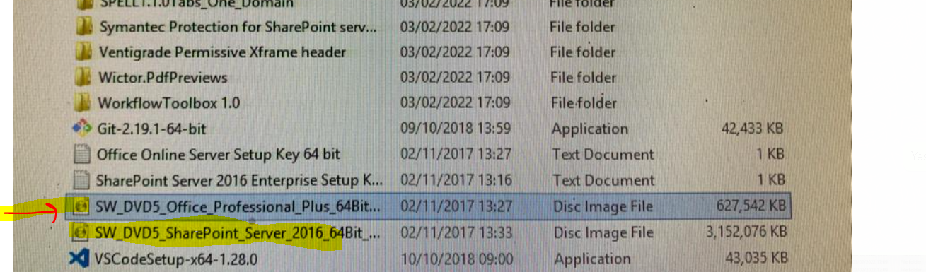

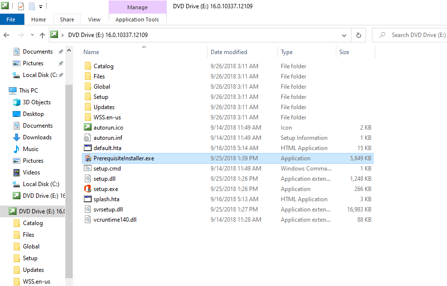

  3. I need to click on prerequisite installer and the once done and I need to run the step up file , am I correct? ( from 2nd step) ( If possible please provide me screeshot of this)

    3. You can directly run SharePoint configuration wizard (needn't to run both prerequisiteinstaller.exe and setup.exe) because you just remove the server from your SharePoint farm, not uninstall SharePoint on your server.
