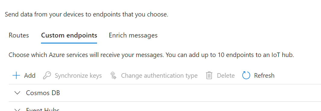

  1. Sander van de Velde | MVP 36,526 Reputation points MVP Volunteer Moderator
    2023-05-02T18:01:01.9433333+00:00
    Hello @Hinata Katsunori ,
    The metrics page on the Azure Function gives limited access to logging information over the past 30 days.
    It's recommended to have Application Insights connected to your Azure Function so you collect detailed function information. This is a very useful UI around Log Analytics.
    Next to that, recently, support for CosmosDB as native IoT Hub telemetry export routing to is added:
    Here is a blog post about that IoT Hub feature.
    If the response helped, do "Accept Answer". If it doesn't work, please let us know the progress. All community members with similar issues will benefit by doing so. Your contribution is highly appreciated.
