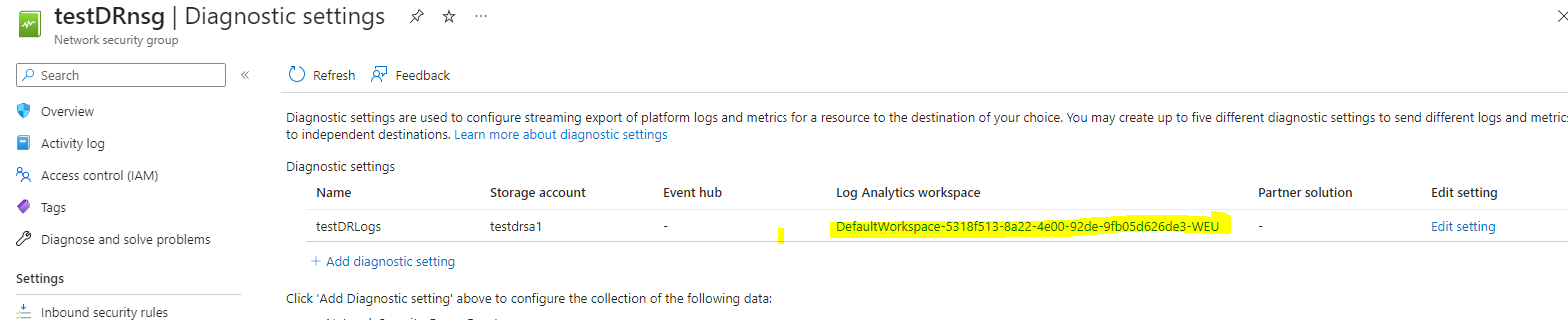

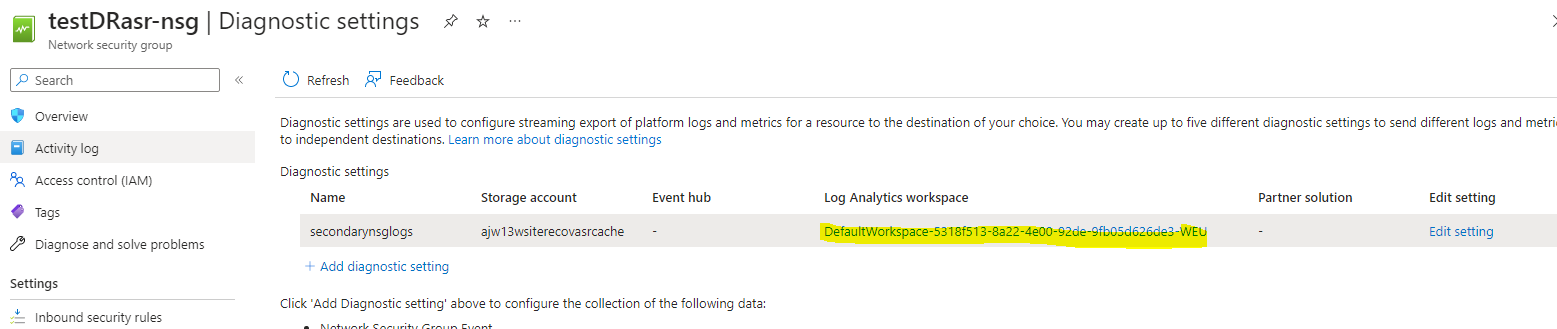

For the same, I enabled Diagnostic settings under both NSG and set the same Log Analytics Workspace one week ago.
MicrosoftTeams-image (3)
MicrosoftTeams-image (4)

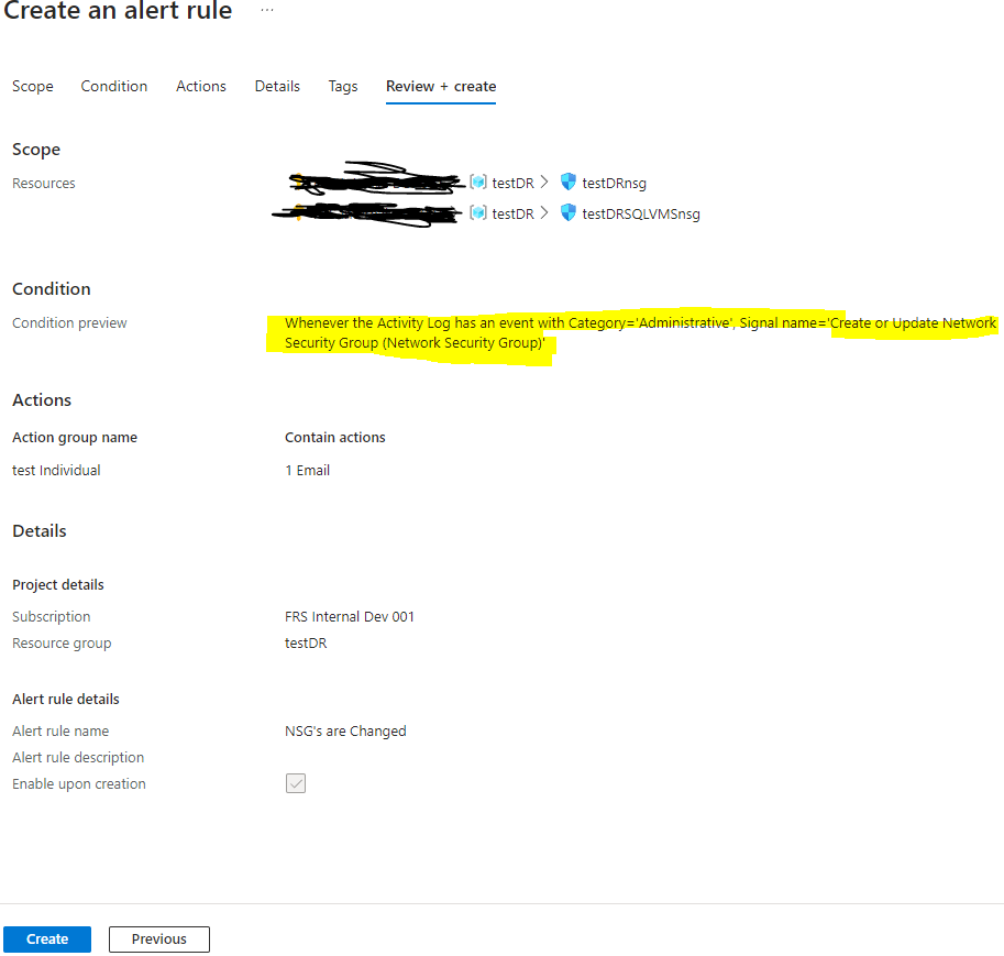

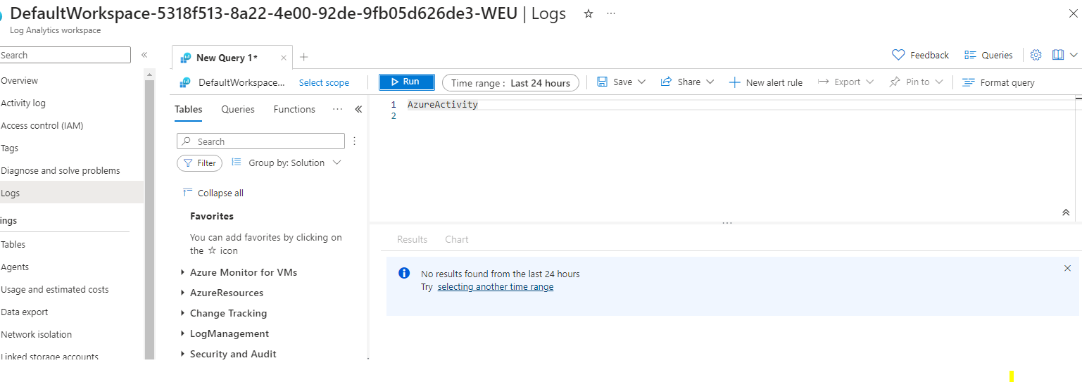

The Table ("Azure Activity") under Log Analytics Workspace won't show me any Results. What would be the cause?
MicrosoftTeams-image (5)

  1. Andrew Blumhardt 10,056 Reputation points Microsoft Employee
    2023-05-02T11:53:56.2766667+00:00
    Activity logs only get recorded when a change is made and are retained for 90 days. A diagnostic setting will only transfer new changes. This method could only find duplicate NSG rules they were both made withing that timeframe. Your workspace may also be on the default 30 days retention. It might be better to query the Resource Graph to compare all current NSG rules. Unfortunately, I don't think you can call the resource graph from an alert rule. Workbooks can query the graph. Maybe a workbook that lists all of the NSG rules and flags duplicates would be sufficient. I wouldn't be surprised if there is already a workbook to help review NSG configuration. I think Defender for Servers does some NSG evaluation called Adaptive Network Hardening.
