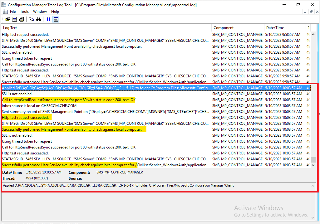

    1, Please help check mpMSI.log and mpSetup.log to confirm that the MP was installed successfully. We will see the records as shown in the following screenshots: Picture1
    2, It's hard to find the cause of the error with the only log entry, please check the mpcontrol.log to see if there is any more useful information.
    3, Besides, please help check IIS log files for further troubleshooting. The location is %SYSTEMDRIVE%\inetpub\logs\LogFiles\W3SVC1.
    4, Please help confirm that if the MP prerequisites are installed and add Site Server Computer account to MP server’s local administrator’s Group.
