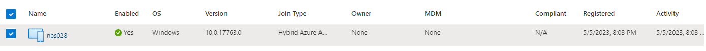

We are implementing device compliance based conditional access in our organization. Its working fine for Windows 10/11 endpoints. However we are facing an issue with set of AD joined Windows 2019/2022 servers where corporate services are accessed by end users. Services are blocked as device compliance for these devices can not be evaluated.
I have taken the following approach to solve this issue.
  1. Get the servers synced to Azure - Done (OUs these are servers present are selected to sync to Azure AD in AD Connect.)
  2. Enable the registration - Done (Group policy for automatic device registration is linked)
  3. Create and apply Device compliance policy in SCCM and apply these servers - Done
However MDM field is still blank, so the device compliance is N/A. How do I get this solved and make these severs compliance status updated in AAD to be evaluated from conditional access?

  2. Konstantinos Passadis 19,576 Reputation points MVP
    2023-08-20T09:25:29.93+00:00
    Hello @Mahesh Veerappa !
    Researching your issue i have found out that there is no reference supporting Server OS for Intune Compliace
    Please have a look here :
    https://learn.microsoft.com/en-us/mem/intune/fundamentals/supported-devices-browsers
    So , i think it is useless to try , but you can work with SCCM to bring your servers under compliance and Co Management as well to have Intune and SCCM together
    https://learn.microsoft.com/en-us/mem/configmgr/comanage/overview
