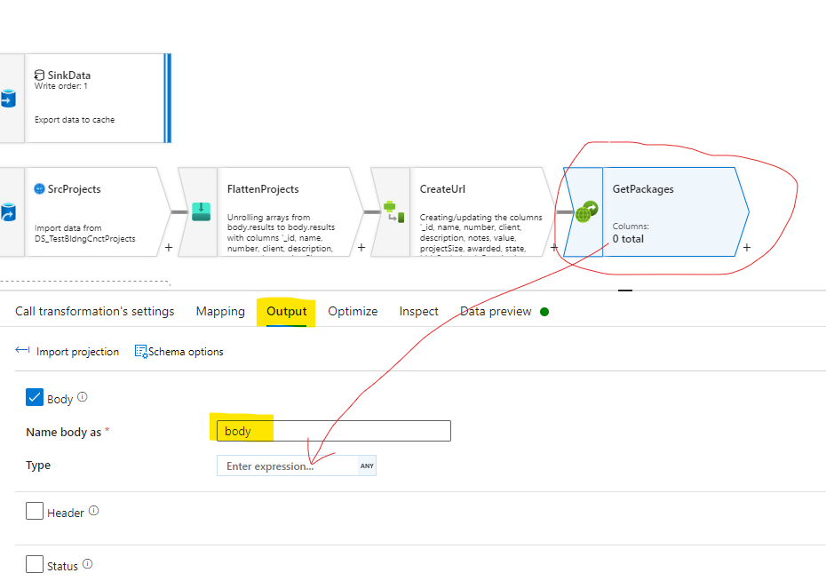

I .. do not understand what I should do with this. I have a REST call that gets the list of Projects. I set up that as a source to the data flow - having a Rest Linked service feed the data.
ADF Data Fkow
The JSON from the REST call is list of Projects objects Something like ...
	"_id": "5a04b1a0",
	"name": "Some name - as string",
	"number": "179",
	"value": null,
	"state": "PUBLISHED",
	"Sealed": 0,
	"ndaRequired": 0,
	"public": 1
and there can be hundreds of those. After the list is obtained, I need to go through each one and make additiona API call to https://<baseUrl>/projects/<{_id}> where _id is a project ID (from above) This call will give me individual project with ADDITIONAL fields - nested "Packages" array

I do not know how (The syntax??) to specify the response schema for each individual "GetPackages" external call. please help. In the "Data Preview" of the FlattenProjects stage, I get the correct list for Projects, and after "Derived Column" I get the additional "ProjectID" as a url to be added. If I test the complete individual URL in postman - it works, question is NOT about correctness of the URL call. what do I put in the "body" and/or "Type", so to get the packages added. ? I can't find any documentation on this, or maybe I do not know / understand what I am looking for to post the rightly phrased question. I can and know how to use Flaten transformation if I need to flatten it afterwards
What do I need to put into the "Type" in the picture, so I can get the
