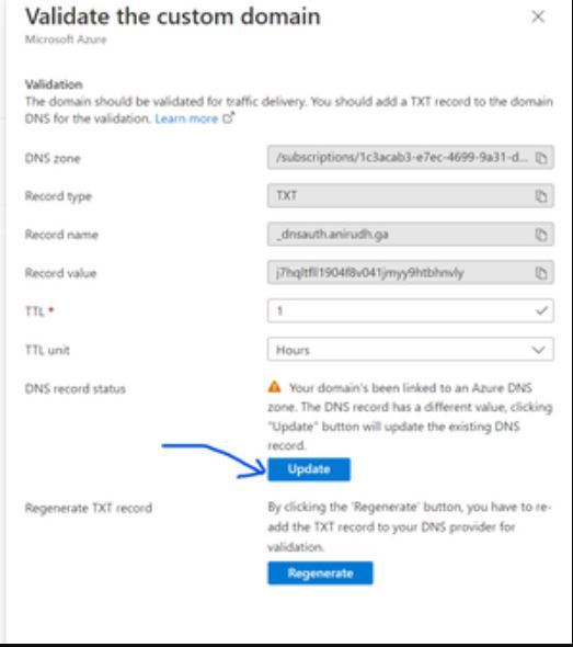

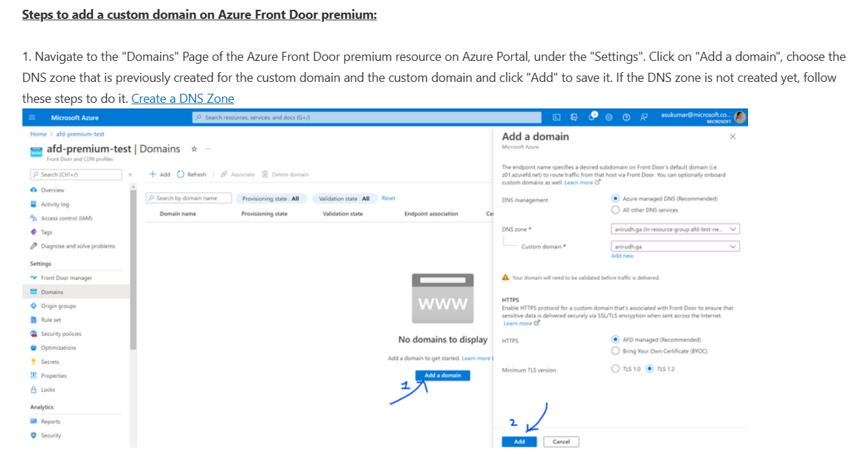

I found this post on TechCommunity where @Aarthi Sukumar goes through the same process but his interface the button @Brett Andrew and I are looking for. See below:
What happens to that button? Any similar function exists via API or CLI?

Below is the answer to your question regarding the "Update" button missing which shows up in the Techcommunity blog.
If your domain is not created with Azure DNS, the portal UI won't offer "Update" button for you to complete adding DNS TXT value by one-click.
As you can see in the step 1 of the techcommunity blog, the domain was added using Azure managed DNS.
