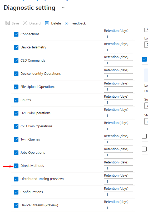

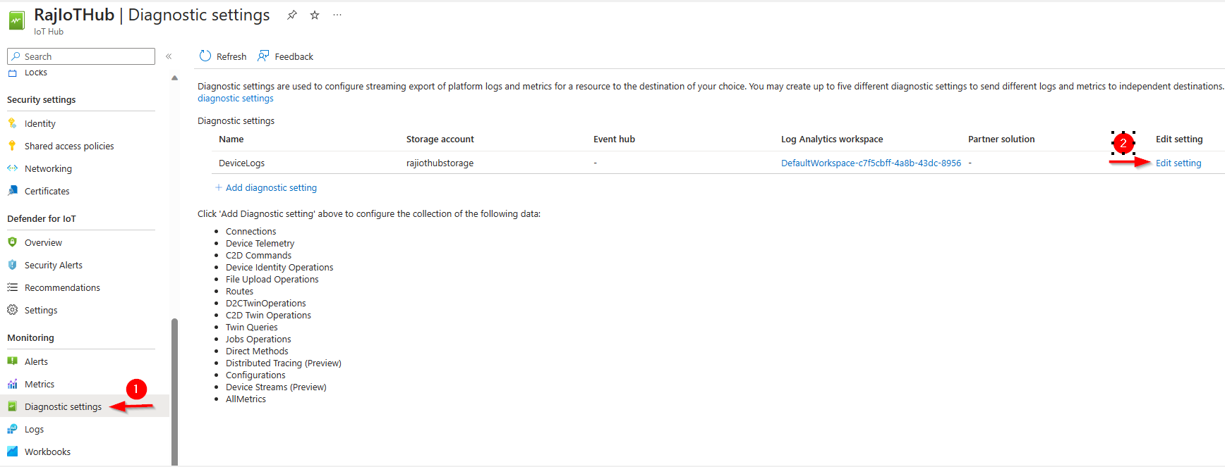

    Inspect the Diagnostic settings of the Azure IoT Hub and verify if Direct Methods category is enabled to be logged into the Diagnostic logs? To check this, navigate to the Diagnostic Settings under the Monitoring section of the Azure IoT Hub. If you have an existing set up that is created to log the events, Edit it to check if Direct Method is selected. Refer the below image for details.

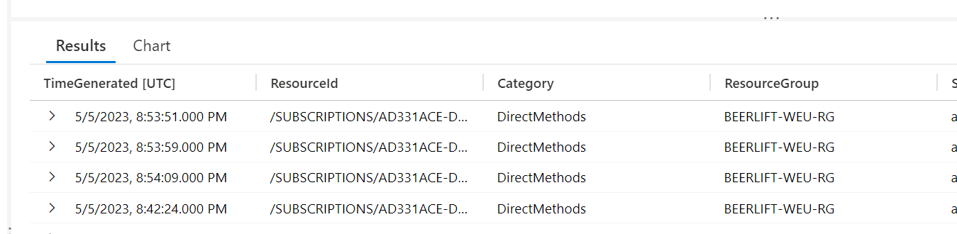

    Kindly note that the approach of your DirectMethod implementation impacts the Category of the event logs. For example, if you create the Direct method using the azure-iot-device.Client class to design Direct Method, the event generated when the method is triggered will be categorized as DirectMethods. However, if you use azure-iothub.JobClient class to create a job, the generated event will be categorized as JobsOperations.
