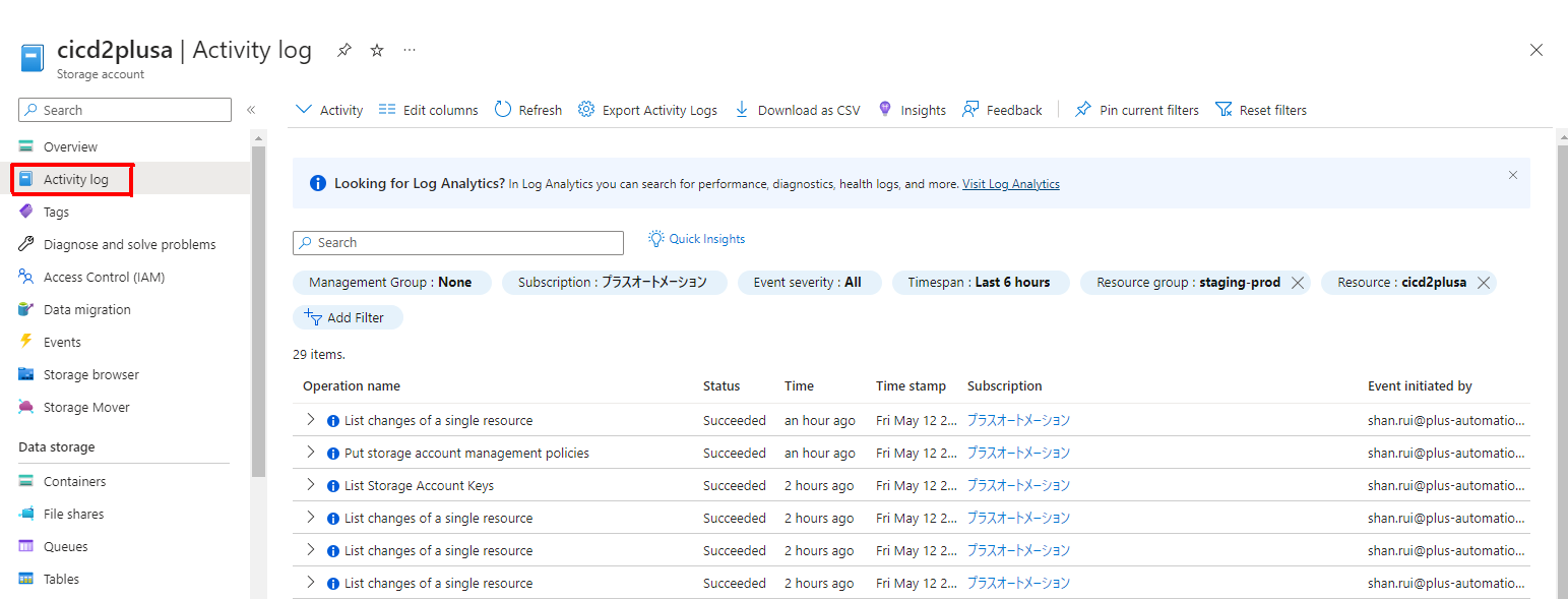

he lifecycle rule has been created for over 24 hours, it should have taken effect by now.
But Block Blob has not been deleted.
There is my lifecycle rule.

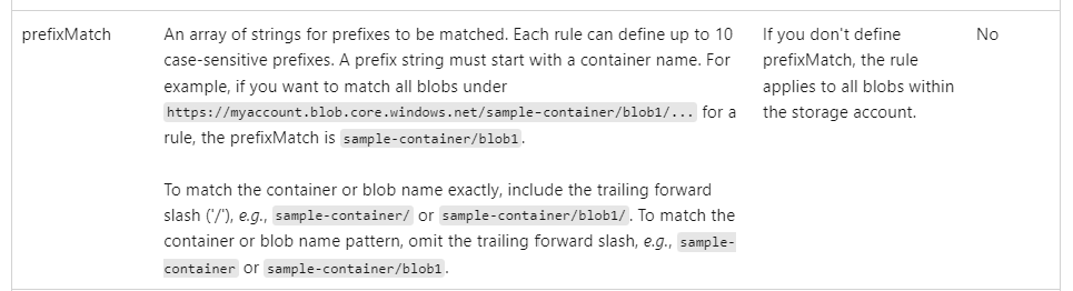

    Does that also include all the blobs in all the subfolders automatically. or do I have to specify each subfolder after the slash as it says further down in the same part of the documentation?
    Yes, when you set the prefix as container name, all blobs (including those in subfolders) will be considered thus you need not specify subfolders specifically.
    You would specify subfolder in prefix only when you want to lifecycle management to manage blobs inside a specific subfolder.
    Please refer Optimize costs by automatically managing the data lifecycle - Azure Storage | Microsoft Docs for more information.
