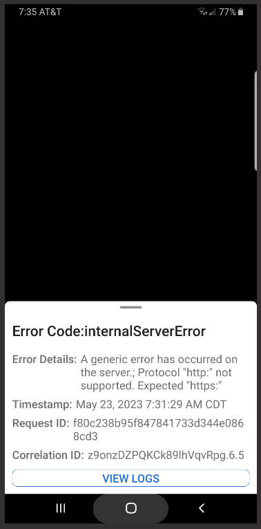

    Once I submit the VC, MS-authenticator is showing me "generic error has occurred on the server. Protocol "http" not supported. Expected "https"
    Appreciate your help.
    Following is the screenshot of my mobile phone ms-authenticator app.
