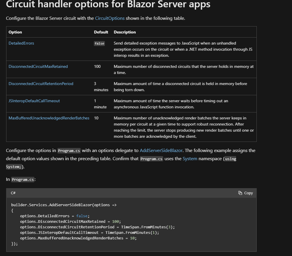

    No it’s not possible. All the state information is memory, and tied to the circuit (websocket connection). this is lost when you switch server process.
    you can have the server persist state, and add reconnection logic to client app via JavaScript. See modify the reconnection handler
    https://learn.microsoft.com/en-us/aspnet/core/blazor/fundamentals/signalr?view=aspnetcore-7.0
