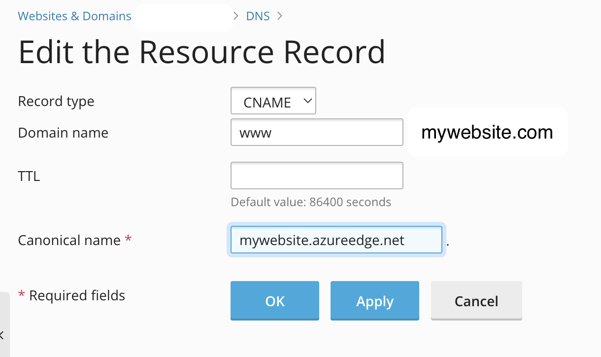

The first question is whether I should create a CNAME record like the below that my website traffic redirects to Azure CDN. Is it right?

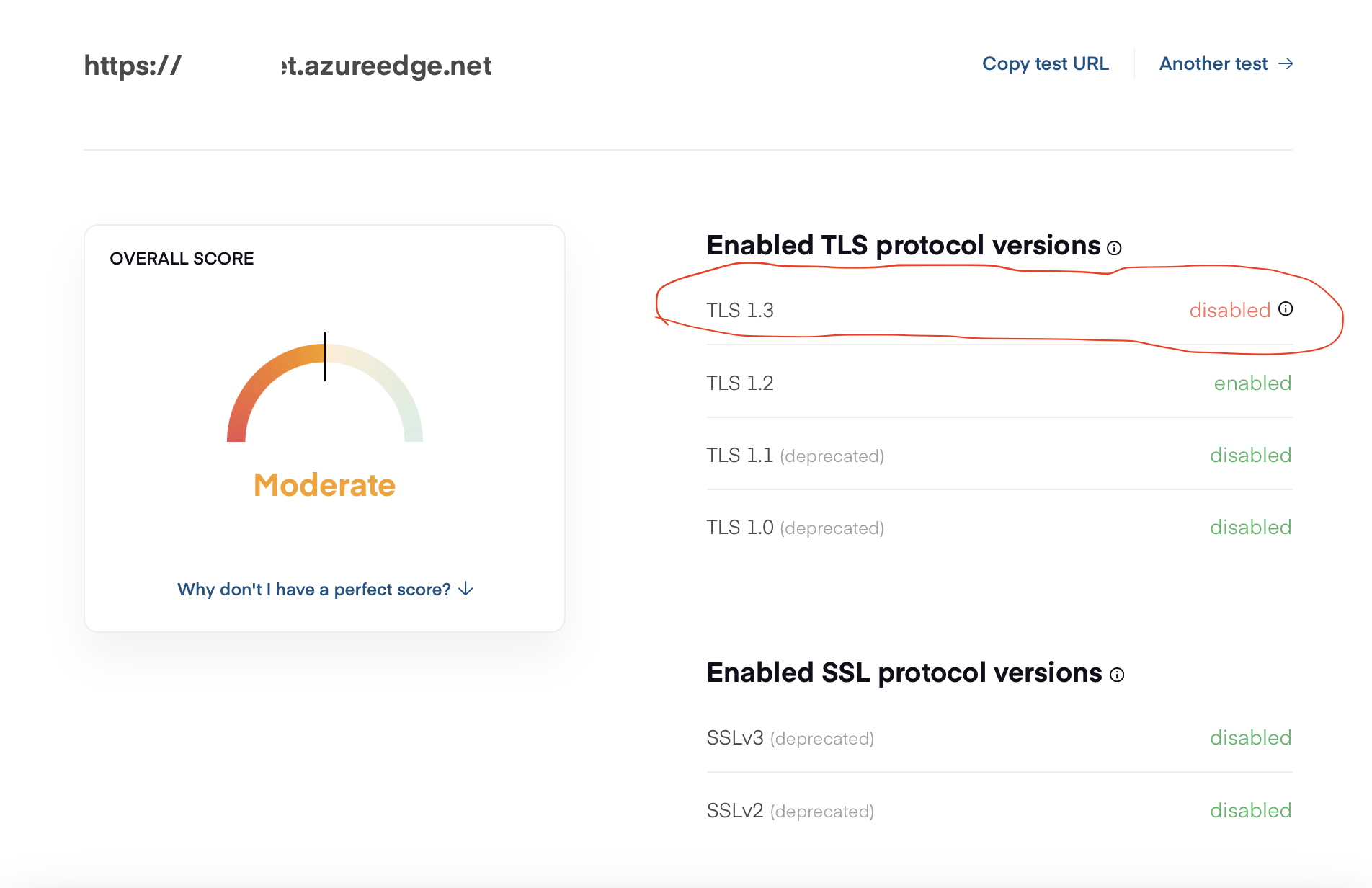

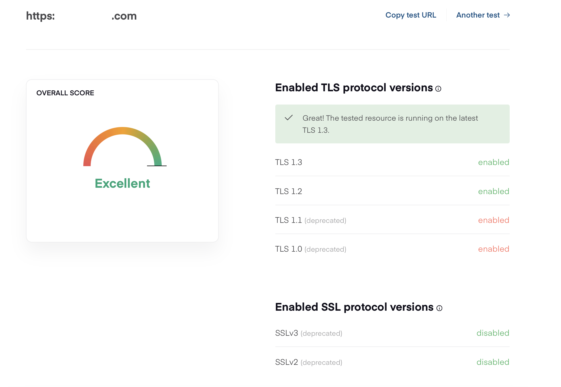

With https://www.cdn77.com/tls-test I tested TLS on both URLs. User's image
The result of my website:
The scenario is, I hosted my website on sharing host that it's not possible to disable TLS 1.1 and 1.0. To fix this issue I should change my hosting plan to VPS.
I want to move my website, behind Azure CDN to fix TLS versioning.

  1. TP 123.5K Reputation points Volunteer Moderator
    2023-05-21T15:46:17.02+00:00
    Currently TLS 1.3 is not supported. Please see Supported TLS versions in below article:
    https://learn.microsoft.com/en-us/azure/cdn/cdn-features

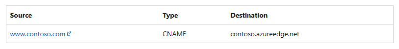

    Whether I should create a CNAME record like the below that my website traffic redirects to Azure CDN?
    Yes, you need to create a CNAME with the below entry:
    • Source: Enter your custom domain name. For example: www.contoso.com
    • Type: Enter or select CNAME.
    • Destination: Enter your CDN endpoint hostname in the following format: <endpoint-name>.azureedge.net. For example: contoso.azureedge.net
    Refer: https://learn.microsoft.com/en-us/azure/cdn/cdn-map-content-to-custom-domain?tabs=dns-provider%2Cazure-portal%2Cazure-portal-cleanup#map-the-permanent-custom-domain
    After that follow the steps in the above document to add the custom domain to your CDN endpoint.
    How can I enable TLS 1.3 on Azure CDN?
    Currently TLS 1.3 is not supported. Azure CDN Standard from Microsoft supports TLS 1.2, TLS 1.0/1.1.
    Refer: https://learn.microsoft.com/en-us/azure/cdn/cdn-features
