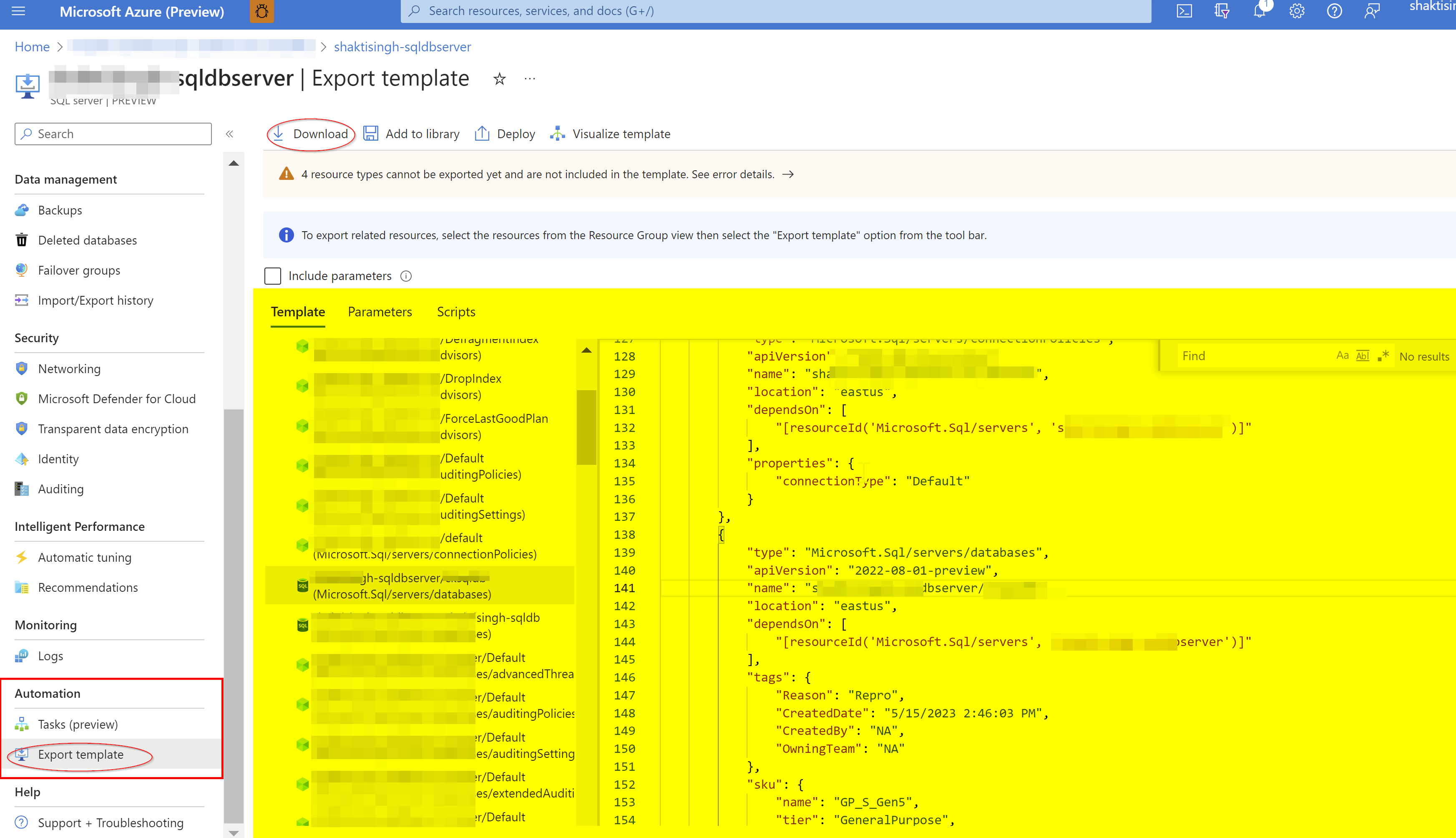

    Export the ARM template:
    Please try to open Export Template Option from the Left Panel of the Azure SQL Database Server pane as shown below:
    This template generated would give all the Databases associated with the Azure SQL database server.
    You may download the same by the option present at the top.

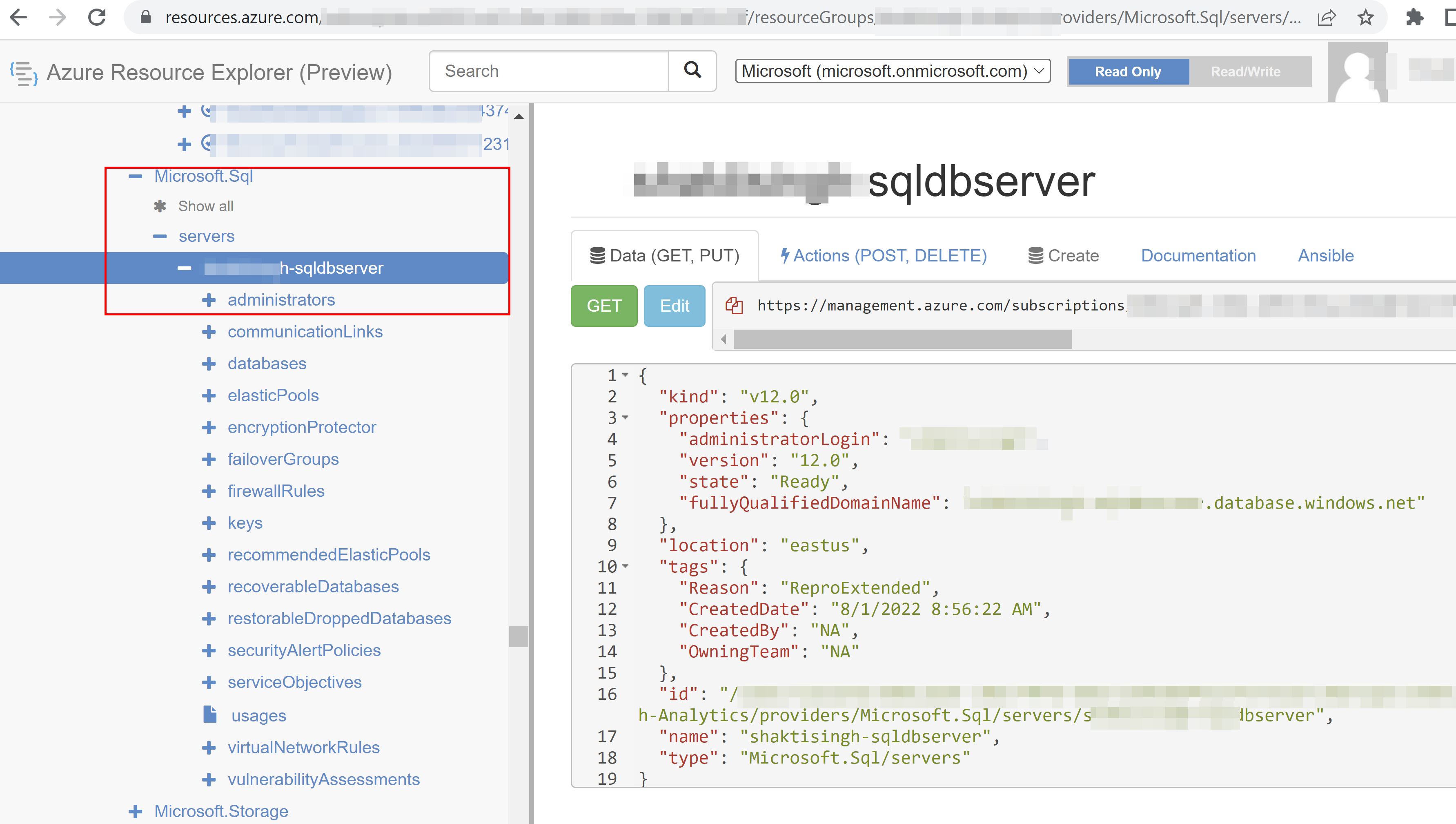

    Azure Resource Explorer:
    The second option to see the ARM template from existing resources is to use the Azure Resource Explorer. You can easily find it at https://resources.azure.com/

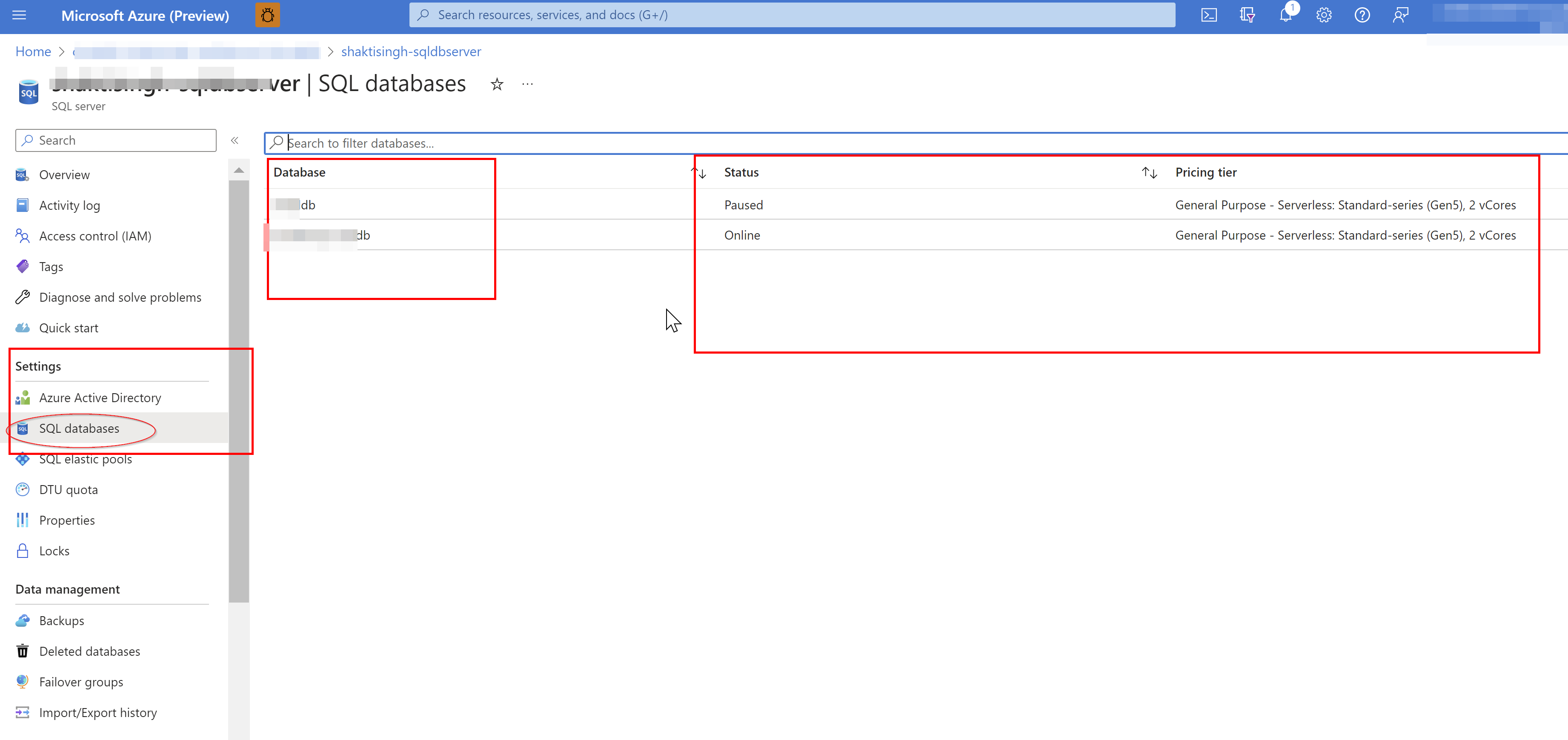

    Additionally, you may see the Databases of SQL Server through portal as shown below:
