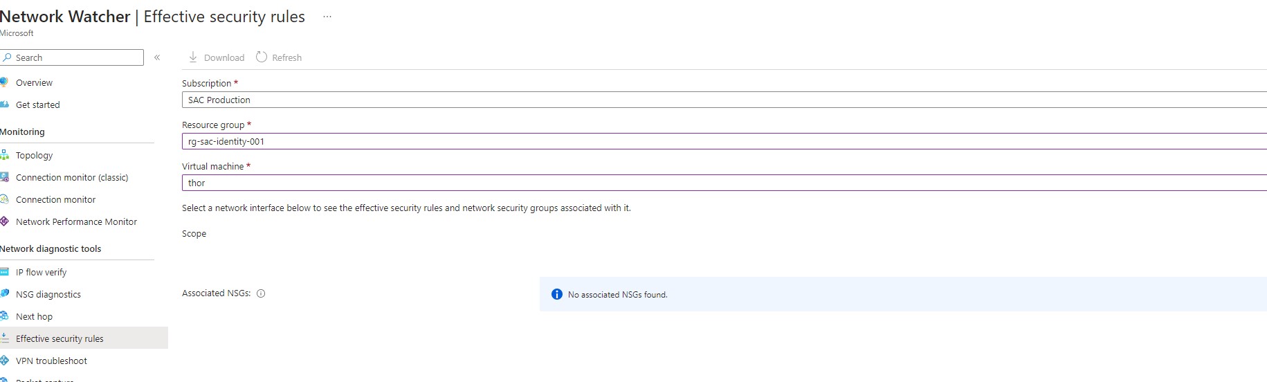

    You can diagnostic on Network Watcher
    Network Watcher's IP flow verify or Next hop capability can help you understand if a rule is blocking your traffic.
    On network Watcher go to Effective security rules, See if you have more NSG associated:

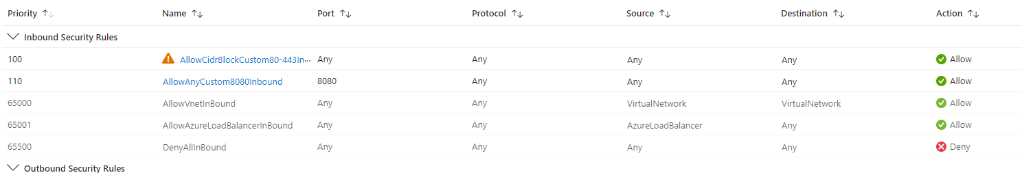

  1. Nithin Johny 25 Reputation points
    2023-05-23T16:00:22.21+00:00

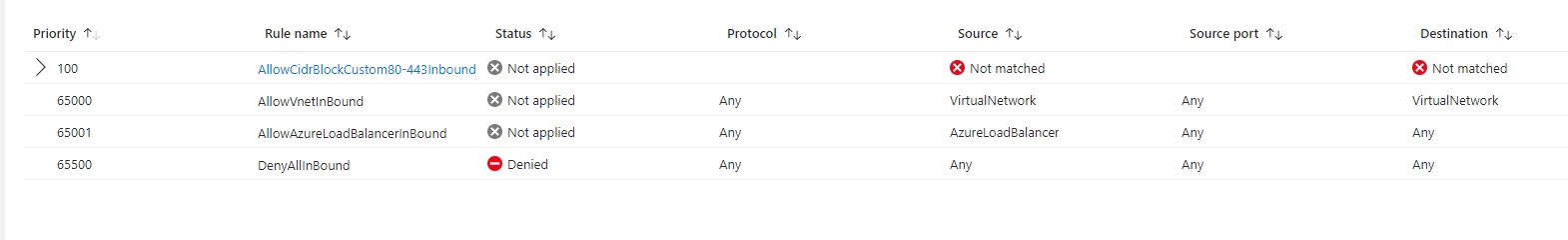

    Hi ,
    I have tested with network watcher ,possible if you can advice me why the Denyallinboud rule take even after I created a different rule with priority100Screenshot 2023-05-23 105939
  2. Nithin Johny 25 Reputation points
    2023-05-23T16:19:39.36+00:00
    But for some reason it is still not working User's image
