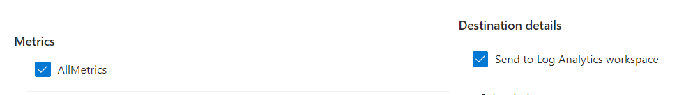

We have some issue with load balancer health probes.
LB has been configured to check a html file in server in the interval of 10 sec . In server we can see the requests from LB but sometimes we can see requests with 25 sec or even more time gap . There is a gap from 25sec to 45sec in server for health probe request and VM is consider as unhealthy during this time period and causing the issue in production.

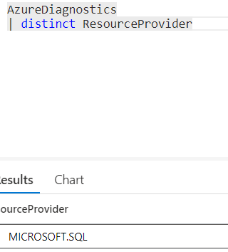

To monitor the Load balancer health probe request and response time in a standard load balancer, diagnostic logs has been enabled to send logs to log analytic workspace . But logs are not logged in Azure diagnostics table. how to fix this ?

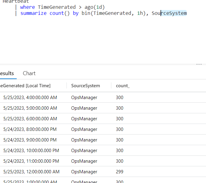

    Check log ingestion status:
    • Use a query like the following to verify if logs are being received:
    Heartbeat
        | where TimeGenerated > ago(1d)
        | summarize Count() by bin(TimeGenerated, 1h), SourceSystem
