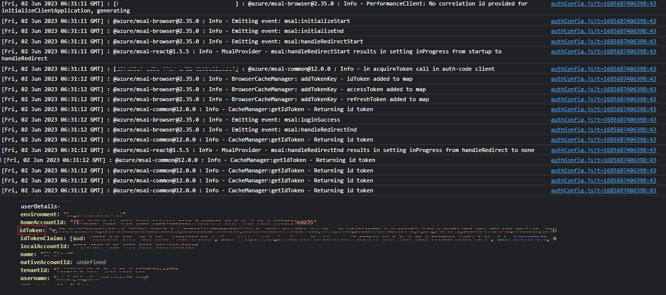

In the first load, I am getting these details in the const userDetails-
    "homeAccountId": "XX-X553252fedd35",
    "environment": "login.XX.net",
    "tenantId": "XX-63c7-XX-91c6-553252fedd35",
    "username": "******@XX.XX.com",
    "localAccountId": "XX-7e21-4730-XX-XX",
    "name": "XX XX",
    "idToken": "xcasdcasdf3adsfa4sdafsd43fadsf43asdfxx"
    "idTokenClaims": {
     XXXX: XXXX
First load- Screenshot

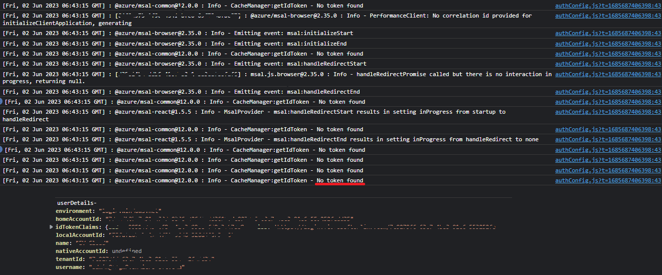

But when I reload the page, the IdToken got missing from this userDetails const.
And in the console, I got this log message after reloading-
@azure/msal-common@12.0.0 : Info - CacheManager:getIdToken - No token found
After reload- Screenshot
